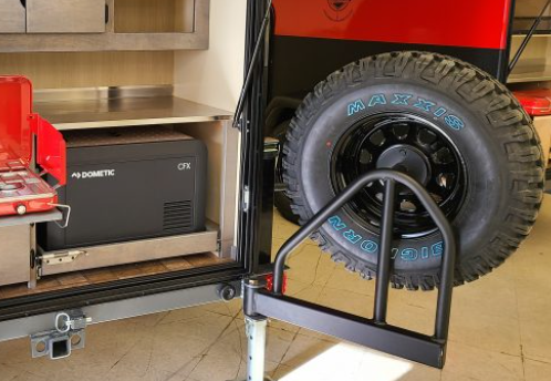

If you do end up locating the spare tire on the rear, I see the maker of the Gen IV trailer utilizes a "Plane Jane" swing away carrier, mounter to the frame/bumper combo.
From the pic you posted above, looks to me that you have the ability to fabricate one.

Crud! Sorry Micheal, I meant on the truck. I'll be putting a dirt bike carrier on the back of the trailer. So I'll end up with a tire on the front of the trailer, and then possibly the 4R tire on the back of the truck.
That's a cool tire carrier though. Nice and simple.

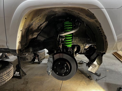

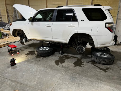

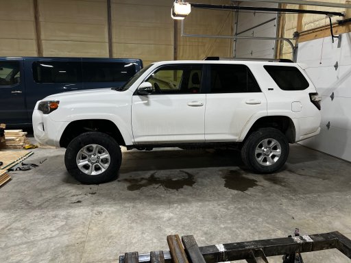

Put in an Ironman lift this evening. Just over 4 hours, with a little help from the wife to align the UCA bolts. (Perfect opportunity to exercise those innuendoes...) Doing it all in one evening wore me out!
I removed the front sway bar and didn't put it back in. Might see if I can get my hands on a set of those new disconnects before I put it back in. Tinkerer's Adventure makes a compelling argument.
If you're considering the Ironman lift, it was about as easy as the video makes it seem, but a few things to note:
- I did not need to remove the battery like he did in the install video.
- There was a hose bracket on the passenger side that needed one bolt removed for the UCA bolt to clear that the video didn't mention. No biggie.
- I did bend the body flange just a tick to get the drivers UCA bold past. Just a tiny bit in the way.
- The rear sway bar is different but maybe mine was easier to deal with. I just disconnected the end of the bar from the link. One nut to deal with there.
- Putting the bushings on the top of the rear shocks was a pain.
- The sequence of tasks in the video is mostly set up for you to complete one thing at a time. Probably good for them to assume installers are novices. But it's not really conducive to speed. As long as you can remember where you kept your nuts, it's easier to remove the UCA, remove the strut, then install the new strut, and then the new UCA.
Wheels and tires go on tomorrow, hopefully.
Before:
During:
After:

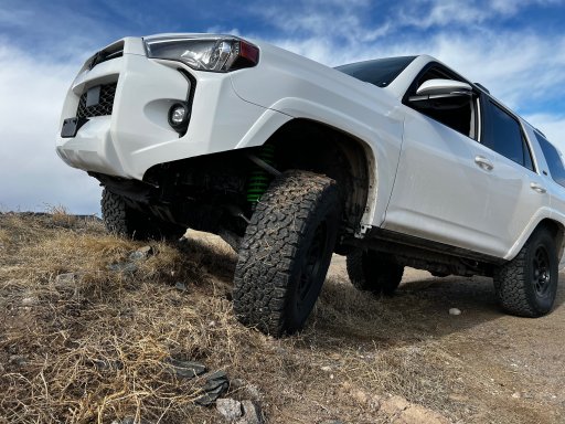

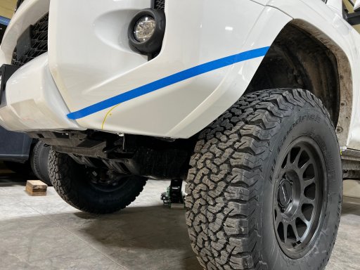

The tires were catching on the front of the fender. The only other rub spot so far will need a small body mount chop. Might even get away without welding on any kind of gusset. It's already an open-ended mount. I think I'm making a decent argument that if you're ok with the high clearance cut and shaving a little off the body mounts, 285/75/R17's will just fit. I don't think I'll need to trim the fender or pull the plastic liner. It's damn close though. I couldn't get it to flex to the bumpstop but it was just a little further to the fender liner than it was to the bumpstop.
I modeled the cut from this T4R Garage's example.
