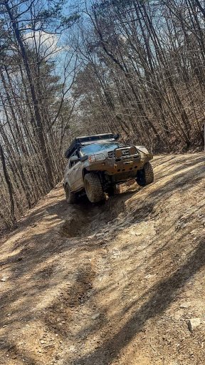

We decided to test the truck out at Uwharrie National Parks UTV trails and camp ground to see how it would perform on basic suspension upgrades and decent tires. Outside of some small traction issues due to non-locking diffs, and hitting a tree or two avoiding rocks puncturing the sidewall the trip was a great success and let me know where to take the truck next.
Since then I’ve added Brute force fab front and rear bumpers with a single swing arm, and have been deciding where to next take the suspension to get better articulation and a better ride with the added weight of the bumpers, 3 Plano boxes, the eventual drawer system and water system and a few more goodies later on down the line. Rock sliders are sitting in the garage waiting to get welded on and have been refinishing a set of old SSR Auswuch wheels that are period correct for the vehicle. 16x8 -1 in the original anodized finish. Can’t wait to get these on and finish up the last bit of wiring for the new off-road fog lights going onto the new front bumper.

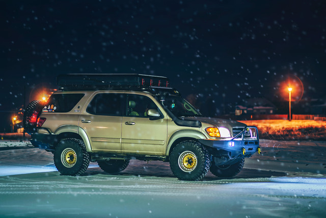

So recently went on our 11 day trip out to the San Juan mountains. After 5-6 trips we’ve finally (my wife and I) got things to a point where we aren’t over or under loaded down and can reach everything without much effort. This isn’t to be lazy mind you, but on these longer trips the least stress you can put on yourself the better you’ll be overall.
To lead; this is a 1,500 mile one way drive for us and even at that distance it was well worth the trip (avg 15.5-17 MPGs this trip). The trail we ran (used Gaia GPS) started in Silverton, to Telluride, Ouray, Lake City, and then back to Silverton. We did have a small snafu on our 3rd (twisted my knee from a small fall from the back bumper) and 4th day (punctured sidewall on a trail) that forced us to cut out a day earlier than planned but this has been our best and most memorable trip by far.
It’s also nailed down some last changes to the rig before we hit Moab next Spring that really work with our style of overlanding; 35” MTs, the wheels finally getting finished, getting the front suspension redone (Fox has been on a massive back order), fixing the rear trailing arms (poor company design) and swapping out to a hard top rtt so I don’t injure my knee anymore (I have two ACL surgeries). Keep in mind there is nothing wrong with a soft top RTT and it sleeps better than a hard top due to space easily, but with the setup having my standing in precarious areas of the truck and my knee situation we both decided it was better to go with a quicker setup to prevent more...oops on a trip.

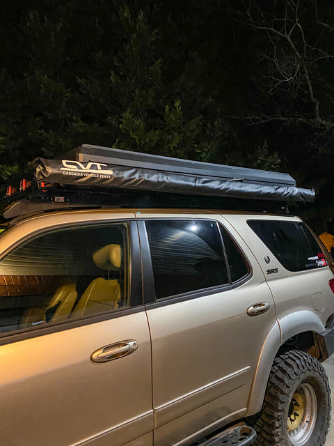

Traded out the soft top 23Zero for a CVT/Busch Alpha tent which is absolutely amazing and also grabbed the CVT 99” awning with built in LED lights. Also finished the front end upgrade; 04+ spindles, new bearings, tie rod ends, Camburg UCAs, Durobump bump stops, and the Fox struts also finally made an appearance. Still need to modify the firewall for full stuff but I’ve had bigger fish to fry. Purchased some trailing arms about a year back that were absolute trash quality. Finally got around to fixing them via some Johnny Joints. The lower joint for perfect but I had to modify the the upper a tad to fit the smaller diameter upper mounting tab on the diff.

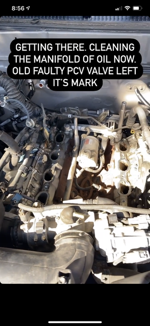

While I was at it I decided to go ahead and be prepared and bought a new starter from Toyota. 9 hours later and the job was done. Had a ton of oil built up and just sitting in the manifold so I’ll also be adding two small oil catches to the pvc system soon to keep things cleaner.

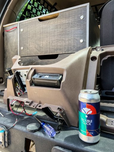

Land Shark Outfitters drawers with a custom wing kit/side door. The fridge slide is a TemboTusk XL I got secondhand.

Removed middle row seating for reduced weight and lower mounted storage
Midlands MXT575 installed in console cupholder location w/ 6dB whip antenna
RAM Mounts passenger seat bracket for 12.9" iPad mount for passenger entertainment and better maps on trail
