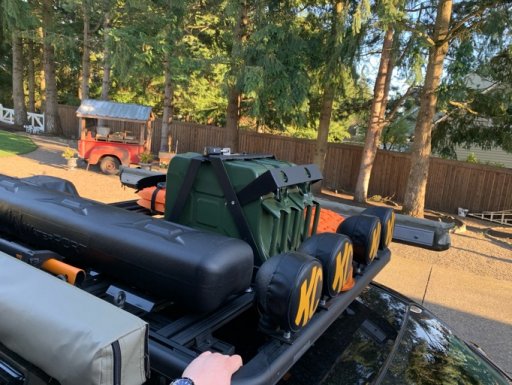

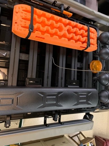

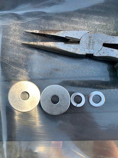

Just installed my EEZI-AWN K9 dual Jerry can mount and I love the look of it but just doesn’t fit the gap as well as I would have liked for $160, however, at the end of the day it’s a much more affordable option than the Yakima branded mounts for literally $120 a pop!? I had to ditch the stock hardware and get some Thule bolt rack systems and then put some washers and such to close the gap! After that, it all came together nicely and if you’re looking for a similar system I recommend this format!

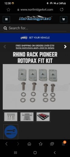

If your rack has the C channels, which it looks like it does, you can get a couple of flat c channel nuts and bolts that fit. Hell the Rhino Rack hardware might work, and the mount plates 2nd pic are the same no matter the rack. You use 2 bolts for each mounting plate.

OMGGG! Those are it! You’re a god send thank you!

That looks like Superstrut hardware. Home Depot will have that in the store. Might be worth checking to see if it fits.
