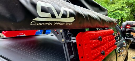

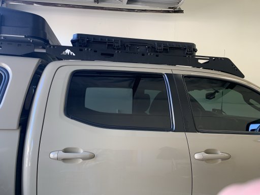

Hi everyone! I have searched endlessly on the internet for answers but with no avail. I currently have a set of XBull recovery boards that I would like to mount to my Sherpa Rack. The rack does not have the drop in points like the Prinsu. What is the best way to go about this?
Picture of my truck for tax. I’d like the boards going the same way as the Plano case.

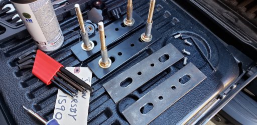

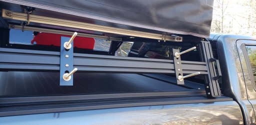

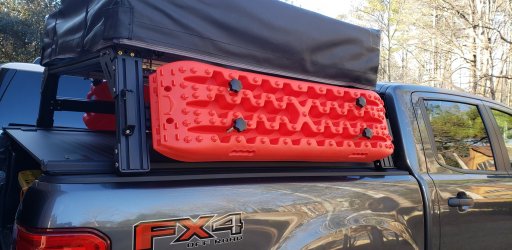

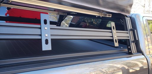

What did you make the bracket out of? I've been thinking about making something similar, but haven't gotten to it yet. Right now my boards are ratchet strapped to the side of my trailer.
The brackets are just flat pieces of metal withe holes drilled into them and then lengths of threaded rod with nuts and washers used as posts.

Thanks for the info. I should have clarified the question though. Steel, or aluminum?

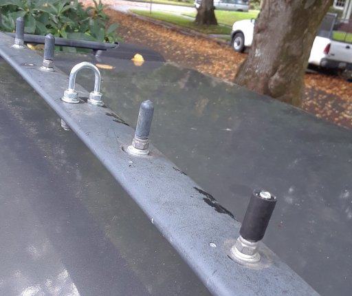

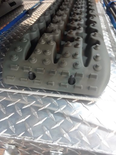

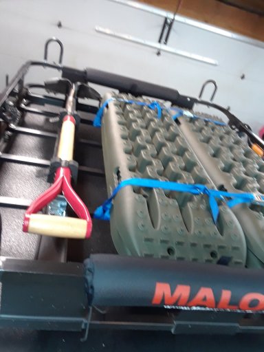

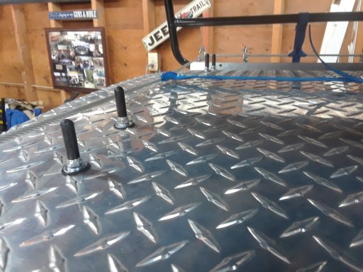

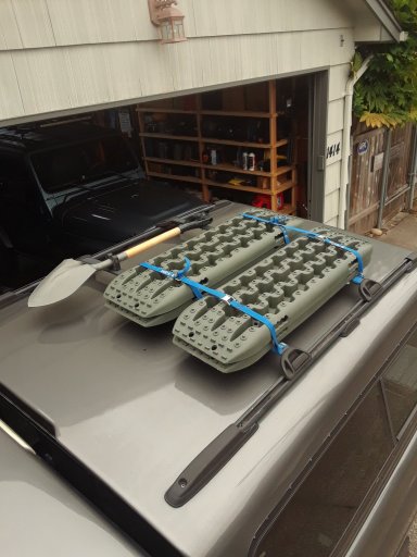

A couple of 1/4" bolts with rubber vacuum caps (or you could use 1/4" ID vacuum or fuel line). Pictures tell the story. I have two pairs of X-bulls. Sometimes they are on the lid of my trailer (first two pictures); sometimes they are on the roof (crossbars) of my truck (3rd and 4th picture); but most of the time they are inside my roof rack on top of the Jeep (last picture). All three mounts are the same design with bolts and vacuum caps. They are strapped down with 1" NRS straps. The bolts only need to be long enough to capture the bottom X-bull since they stack on top of each other.X-bull.8.jpgX-bull.6.jpgTruck rack.2.jpgroof rack truck.2.jpgShovel.1.jpg
