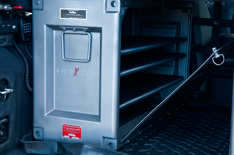

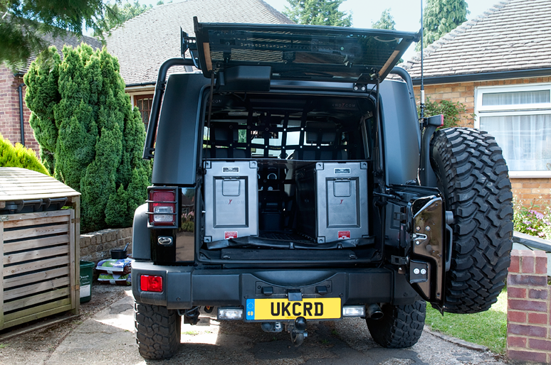

This project was to make expedition set-up for the rear of the my 2 door Jeep Wrangler JK. I bought as couple of ex-MOD flight containers and restored and modded them. I made a lightweight top that effective binds the two and allows for a second tier of storage above them. I used aluminium covered plastic sheeting for that and 3M Dual Lock strips to hold them fast to the containers. For about a $100 investment it's a decent setup and has served me well thus far. It's quite handy because when at camp you just lift the two containers out, add the top again and you've a sturdy camp/work table.

Hello Duncan,
Those are vey nice boxes. What a brilliant idea.

Very nice I like it! Just this past weekend I installed a fold down tailgate table for our trip to daytona beach Florida for jeep beach, we leave this weekend can't wait!!!

Nice storage solution for the Jeep, Duncan.
How sturdy are those cases?  Can a 180lb guy stand on one without deforming it?  Are they weather-tight?

@deeker Oh they're sturdy are heck. I would say 3 men could stand on one at the same time and it wouldn't budge! They're ex-MOD and cost £25 each off eBay when I bought them.
UKCRD
327
This is what they looked like when I bought them. http://4wdx.com/?attachment_id=1403
