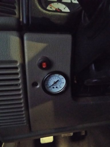

I installed the Viair constant duty kit on my Jeep several years ago. I love compressor, relay/switch, and tank. But I've, replaced everything else. I replaced all of the hose with stainless steel braided hose. I put one quick connect on the rear of the Jeep and one on the front. I run 33's and can air up using one hose, from 16 to 32 in less than 10 minutes or so.
