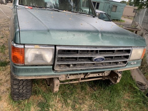

So I’m still new to the process of building overland vehicles, (I come from the Prerunner/Desert Racing community we don’t use winches hahaha) so I have a couple questions for a winch.
What’s the mounting process for one? Can I just fabricate a location behind my bumper (pictured below) and attach it with bolts, or should I weld it?Here’s the bumper freshly fabricated a month ago, any help/advice appreciated!

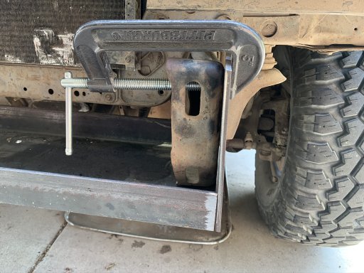

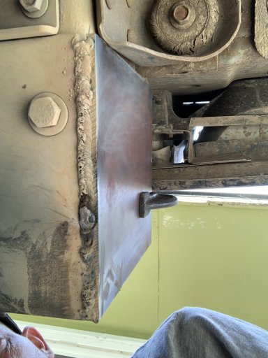

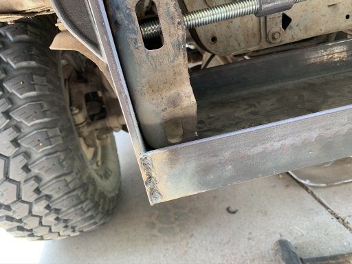

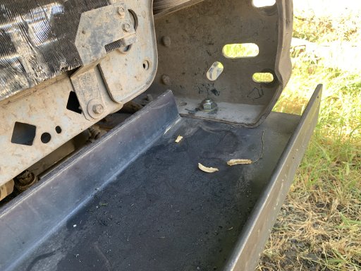

Don’t weld the winch mount to the frame… if for some reason you need to pull it off, grinding and cutting sucks… since you have a Chevy Silverado, you can get winch mounts made specifically for the winch you are using and your truck.
Making a custom winch mount is easy as well… I hope my pictures show how simple it is.
4AAFD666-004C-4913-8466-71A4B02A54F2.jpeg73C710BF-B1AF-41D7-9CD2-B879042B0D77.jpeg30301866-B9AA-4F61-81EA-F65B48C29893.jpegB1F9295B-B13C-4589-AE1D-77BF454E1C02.jpegA3088895-49DE-4FC0-A183-44898A258CF6.jpeg
