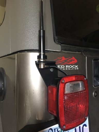

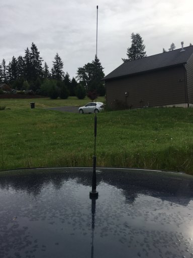

I have a small NMO antenna on my full size truck that I mounted thru the roof. It has a spring on it that has kept it from breaking on three limbs. On my Wrangler LJ that I’m starting the overland build on, I used this antenna.
It is mounted on a tail light mount. Given the wrangler is a fiberglass top, there’s little interference. It’s a tall antenna that doesn’t require a ground plane and can fold over if needed.
Hope this gives you a couple ideas. When I get home I can post a couple pictures of each if you’d like.

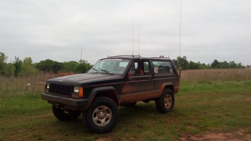

I run long antennas up high and smack them on multiple trees daily, have yet to break one.
If you ran the mount down lower such as the ditch light or fender mount the antenna has more than enough give to not require a spring. If you have a tree branch running that low that it could break the antenna, the antenna may be the least of your worries.

Yes, photos would be appreciated.
Here are a couple pictures.
This is the NMO mount thru the roof of my Dodge 3500.
This is the Wrangler LJ.
The Dodge has a Kenwood D710 and the Wrangler has a Yaesu FTM400. Both have nice flat SWR and I’ve been able to transmit 40-50 miles pretty clearly (obviously terrain permitting). Even longer distances when the elevation difference was in my favor.
Hope these pictures help. I can get the model number of the antenna on the Dodge if you want it.
