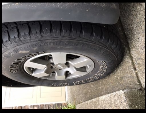

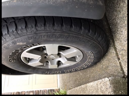

Matters a lot on the tire and the vehicle , the previous owner of my xterra put a set of E rated tire and they are like bricks on this thing . They are down to 18 psi in these pics , at 25 you wouldn’t know they are aired down .
But for the most part gravel roads 18 psi
Snow 12-15 , Only lost a bead once but with a ratchet strap and a air compressor it’s pretty quick to get it back on the bead.
