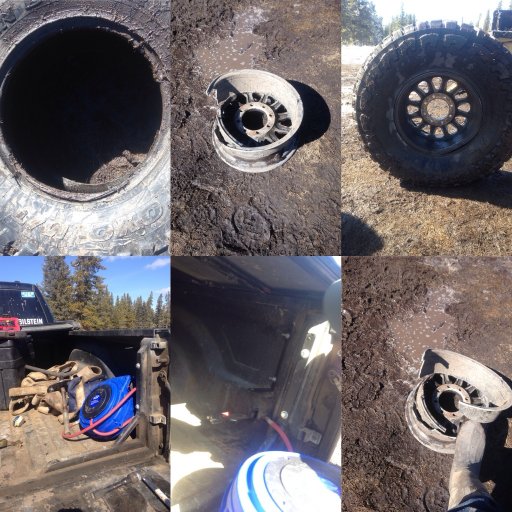

I'm running stock too, because the factory Alcoa wheels are really hard to beat. They're very strong. A lot of people rush out and ditch the factory wheels for the aftermarket. And they don't check the load ratings of those wheels or consider if the wheel is strong enough for the application. I'm sure most purchases are all 98% based on appearance.
Steel wheels can take abuse, and sure you can, in theory, pound them out (have fun with that); but I see you're in a fullsize, not a jeep. Steel wheels will be about 10x easier.
That being said, I've seen Method's explode just from wheeling in the mud
