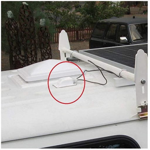

If you must go through the roof of your vehicle, RV, hardshell RTT, etc, gland nuts are great, as mentioned above.
Even better in most applications are entry cable glands; gland nuts enclosed in an entry that allows the gland nut(s) to be at a right angle to the mounting surface and further protects the hole itself from ingress of any weather. I'm using these on my van and hardshell. I point the entry to the rear of the vehicle or trailer. Excellent solution, professional looking, and long-lived.
(not my roof, though shows a good installation)
Most of us can use either a single or double, and they often come in white, gray, or black. Best suited to round wiring and cables.
Here's a whole page from which to choose: Entry Cable Glands
Be patient, know where your wiring will be routed inside, and figure it all out before drilling.
Good luck with your project.
