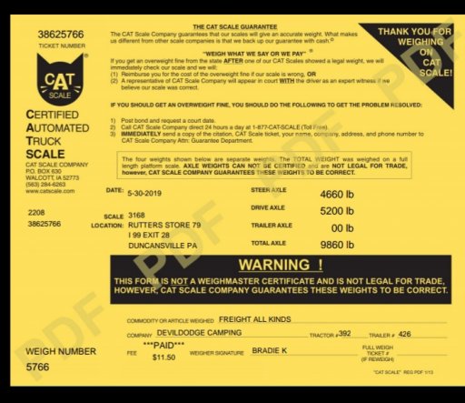

My truck usually weighs right at 8000lbs heading to camp.
But...my truck works alot and spends many days loaded near Gross of 10k
If you do not have the CAT scale app...it is worth getting.
My axle weight ratings are 5500 front and 6000 rear. So even almost loaded...still some capacity left.
Your RAM 1500 has 3900 front and 4100 rear

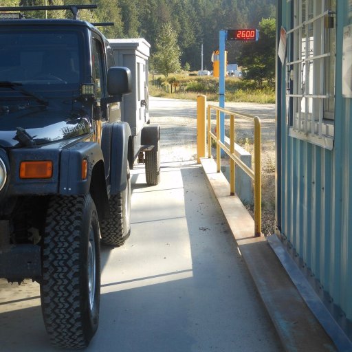

this ^^^ we should all scale our rigs fully loaded at least once.
I do mine at the dump for free.

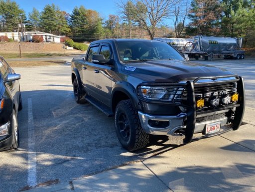

2015 RAM 2500 6.4L 4X4
Bald eagle is a great place to get off pavement and do some dispersed camping.
Hoping to get there again in the coming weekends.
Check out the links above for some more info.
Sounds good. This is my rig right now
