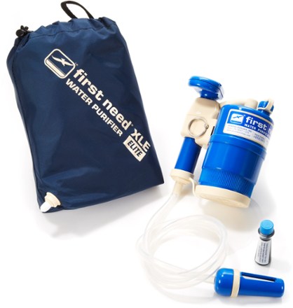

I bought one of these:
back in 1999 when I started to do solo back packing trips. I've been using it ever since, and it still works great. Filters bacteria, cysts, and viruses. I've stuck this in some straight pond scum an poured out crystal clear pure clean water.
This is the same model that my uncles, who taught me how to backpack and rock climb, had when I was a kid, and theirs still work too.
Now-a-days, I only use this for emergancy since I primarily do car camping and I have the ability to transport around 10 gal of water with me at all times.
