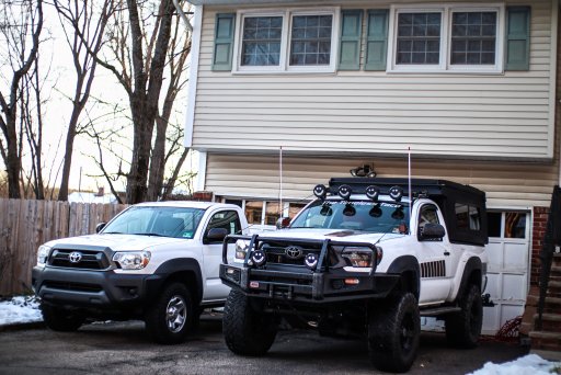

I had to fight my inner critic hard on this one to follow through with uploading it. I had to add a bunch of audio due to issues and all. A more refined edit is on the way, and so much has changed since recording this, which helped me convince myself it was ok to upload this one for now.
Hope you guys derive some helpful information from it! Big thank you to Evan for manning the camera for a lot of this video!
Build breakdown 2013 Toyota Tacoma
5 speed manual
5.29 gears
Powerbastards high output alternator (220 amps rather than the stock 80 amps) https://www.powerbastards.com/proddet...
Rear locker
Flippac camper with my custom fabrication added
Custom made bed drawers
Bluetti AC200p Bluetti charger1 alternator charger
400w of flexible solar panels on the roof Smittybilt synthetic winch 9,500lb ARB front bumper Smittybilt defender roof rack
KC daylighters
Morimoto XB amber headlights
Timbren SES bump stop replacements
Wet okole seat covers
RAS Road active suspension https://activesuspension.com/products...
35 x 17 Yokohama Geolandar XMT
Raceline raptor wheels
1985 Toyota factory stripe kit from James deans creations https://jamesdeancreations.com/1984-8...
Bluetti alternator charger (560w charging capabilities)
