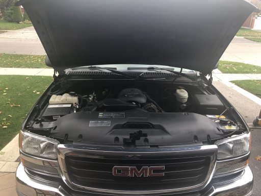

I hope that this thread can assist owners of similar age GMC Sierra's to make a list of tools that are essential to work on these older trucks! The reason that we now have a section dedicated to Overland Tools in the Overland Gear section was because I was finding it hard to find online a comprehensive list of Hex Keys, Ratches, Sockets, Spanners & Wrenches required for my tool roll. I am looking forward to these Vehicle Specific threads being a valuable resource to OB guests and members. Best wishes Amanda.
