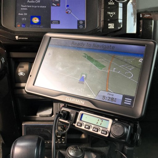

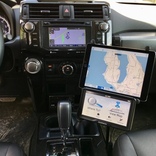

Too used Kevin's @Lifestyle Overland setup as a base point. I used the longer 12" tube in my 4Runner to give plenty of room. I also used a motorcycle mirror RAM mount and another base part way up the tube where Kevin has the velcro clip for even more support.
Usual setup is my 7" Garmin and Midland MXT115 radio.

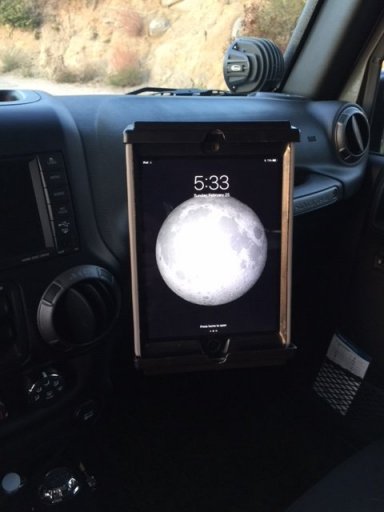

But I've also mounted the iPad for Gaia, too. (This was when I had the 9" tube)

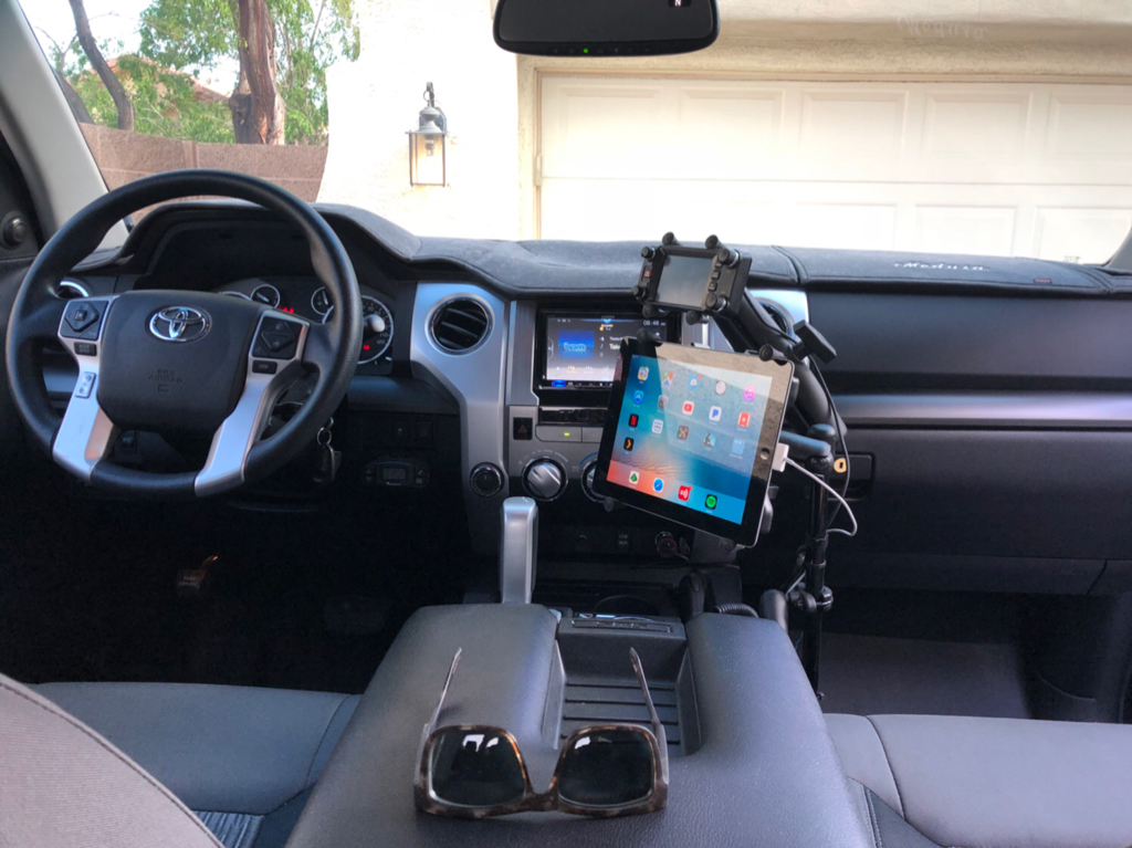

Looking into the company, it seems like they have plenty of options and add-ons to make a very nice system. Y'alls setups look like what I'm shooting for, especially if I add an extra arm to move the screens closer to the dash for passenger comfort. Also, I really like the idea of mounting the radio to the arm. I've been using a hand-held CB due to not wanting to drill into my brand-new-to-me car, but that is a wonderful alternative. How is the off road stability of the mounts in your experiences?

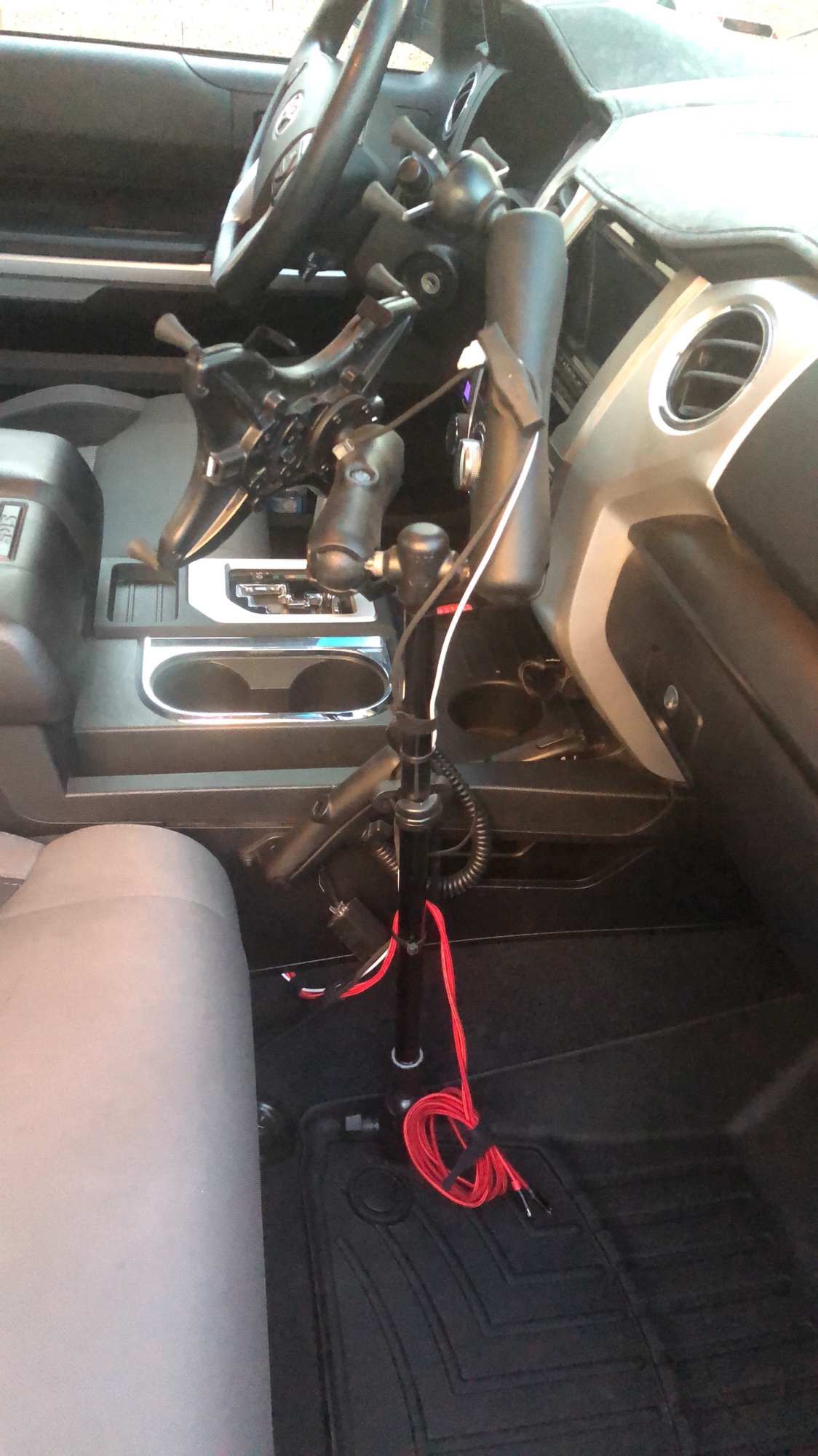

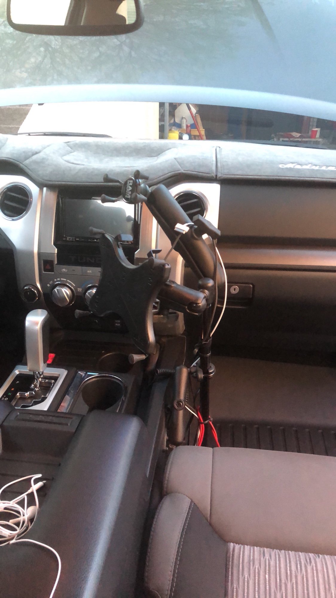

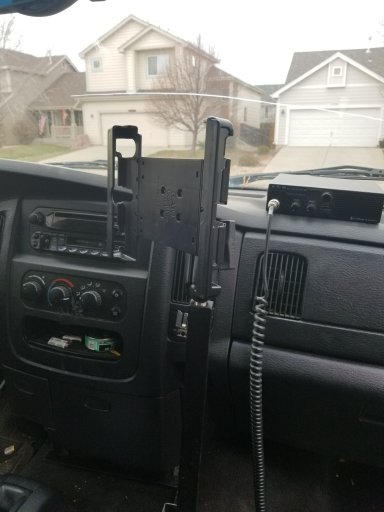

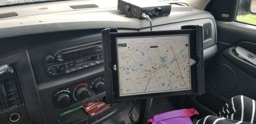

I had to add the stabilizer side arm that bolts to the center tunnel, and the size C stuff is strong. It bounces a tiny bit but very useable at speed.
