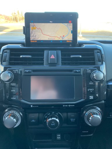

For what it’s worth, i run a Dual 150 paired with a wifi only iPad mini. I use x-motion for offline maps and this combo tracks routes very well. Accuracy is good. Loading the offline maps is slow, but very nice detail. I wasn’t too keen on subscriptions, so liked that you buy the Dual and you’re done. I’d used x-motion for hiking with an iPhone many years ago, so am a bit partial.3303C969-DDD7-496E-B372-9DDFA482E879.jpeg

For what it’s worth, i run a Dual 150 paired with a wifi only iPad mini. I use x-motion for offline maps and this combo tracks routes very well. Accuracy is good. Loading the offline maps is slow, but very nice detail. I wasn’t too keen on subscriptions, so liked that you buy the Dual and you’re done. I’d used x-motion for hiking with an iPhone many years ago, so am a bit partial.View attachment 91927
How do you have the tablet mounted? I like that location!
