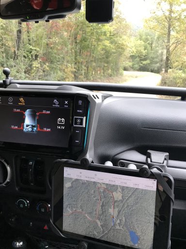

We use Gaia with a mini iPad4 with cell service on a ram mount while in the Jeep. Download the trail map on the way to the trail if you forget to do it before you leave the house like we do. It downloaded 5 layers in under 10 minutes while we were airing downTray Mtn Gaia trip 10-27-2018.jpg .

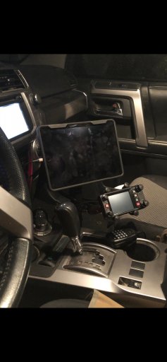

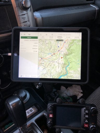

We use Gaia with a mini iPad4 with cell service on a ram mount while in the Jeep. Download the trail map on the way to the trail if you forget to do it before you leave the house like we do. It downloaded 5 layers in under 10 minutes while we were airing downView attachment 74184 .

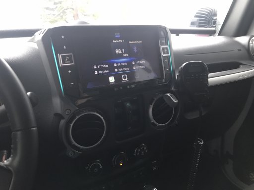

What mount is that on the oh shit bar? I have a similar setup. I’m beside myself that we finally got waze to work with apple car. Wish Gaia worked on the alpine. IMG_8551.jpg
How is that grab bar clamp working for you? Was looking to get one for my Jeep but I have heard it has issues, especially on rocky/bumpy trails.
