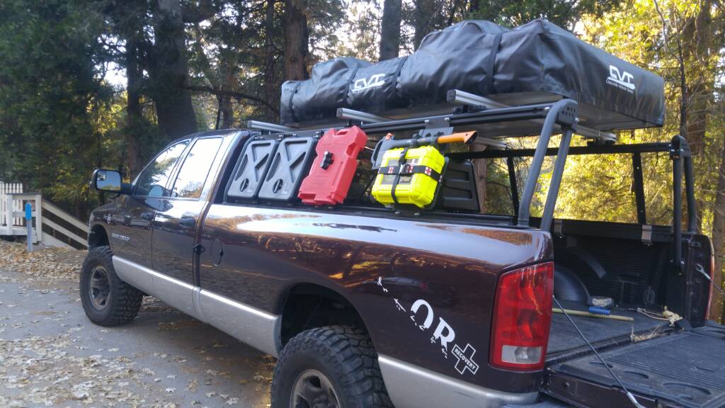

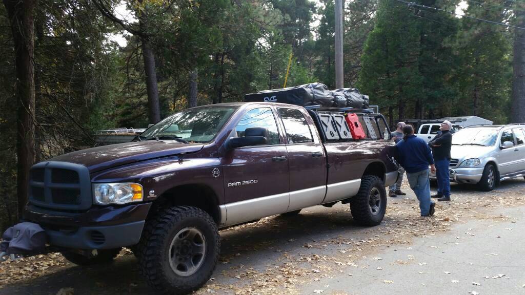

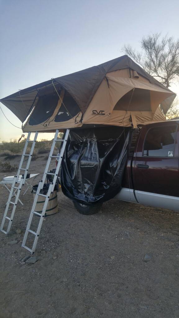

Its completely up to you. I have a family of 4 with myself included and my ram is pretty much perfect for us.. I have a Leitner Designs rack with accesories and an rtt and it's absolutely awesome....

If you take a look at the cvt tents website they sell a myriad of racks to go With their tents.. From racks for above the cab tents to racks that allow you to mount the tent at cab height or below...

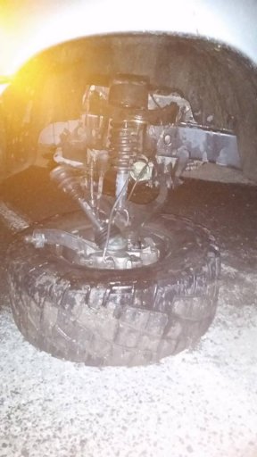

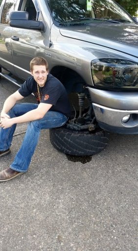

Can you explain the "blown out" aspect of the upper ball joints? Did they fail or did they just become loose? Anytime you add more tire to a truck, the ball joints are (in theory) going to take a little more abuse.
If they were just loose, were they being inspected properly? I know every time I took my old Ford Ranger to a repair shop, I would get quoted for lower ball joints due to being loose, but most shops were checking them incorrectly. I can't remember which way it was but if you checked them with the suspension hanging (or was is loaded) the ball joints would show loose. Checked incorrectly, even new ball joints would appear loose.

It was a catastrophic blow out. The first time happened when I was blasting through mud puddles on the side of the road and the second time happened when I was just driving down the road. Basically when I bought the truck the previous owner had put Bilsteins set at 2.5 inches and then a 1.5 inch spacer on top of that without a dif drop so a 4 inch lift up front so the ball joints were already maxed out and after a few thousand miles the ball joint tore out of the control arm. It happened on both passenger and driver side (both times cost $2k to fix). I took that out and put Fox coil-overs on set at about 1 inch of lift and Zone upper control arms which are meant for lifted applications. I know it wont happen again because its all within normal geometry now but I have this irrational fear that it'll happen on a trail and I'll be screwed.
10354237_10153187468049634_2726500662463680489_n.jpg 10562935_10152645434499634_5242892809464638516_n.jpg

Woah....

yea.... Thats why I have vehicular hypochondria haha I would hate for that to happen on the trail because I have no idea how I could trail fix that haha
Yeah... no joke. On the real though, keep the truck ;) ...but I'm not biased or anything LOL
