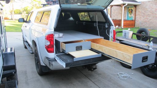

Looks pretty good! What sort of drawer sliders are you using, got a source? Have they been strong and reliable so far?
thanks. i first saw the price of 60" slides and decided to make my own slides using roller skate bearings and unistrut, but i didn't get them to work all that great, so i ended up biting the bullet and buying some on amazon. they are great slides and very heavy duty, well worth the money. rest of the box is 3/4 plywood. i made two separate boxes because they are very heavy and if i take them out, it is easier to move and store them.

That set up looks nice! Those are the slides I'm looking at too. Great idea.
how are your plans coming? i was thinking about how i would use an 8' bed and one idea would be to make an 8' box and use the 60" slide for a 5' long pull out drawer and the remaining 3' left at the rear of the box could hold a water tank and battery that i could access with a hatch. there are so many ideas and set ups out there its hard to choose. i just try to make things scalable and modular.
