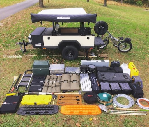

The page on your trailer says Gear Capacity: 1,000 lbs.
Most military trailers--if thinking about one like an M416 or Bantam, the most typical Jeep style trailers--are 1/4 ton trailers, meaning 500 lb capacity. They weren't really meant to have overhead racks and tents, either, but a lot of guys do it.
That page also shows a blog post from Sonny in Albuquerque with a rack and RTT on his Space trailer, so someone is doing it. Might want to try and get hold of him to see how it's holding up over the road, or better yet get hold of Space trailer people to see what they think of your possible upfit plans. Personally, I'd think the Space trailer was too light for RTT use long term.
Whatever trailer you end up using, you'll also have to figure in the weight of the rack and platform itself.
My trailer, with a cargo capacity of over a ton, with a gross vehicle weight of 3275, has a Dexter torsion axle rated for 2500 lbs, which has proven to be more than enough so far, with RTT, big awning, and a ton of gear as cargo. But it was designed with a rack and RTT in mind, too.

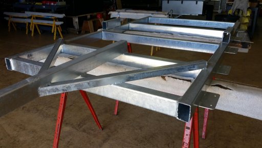

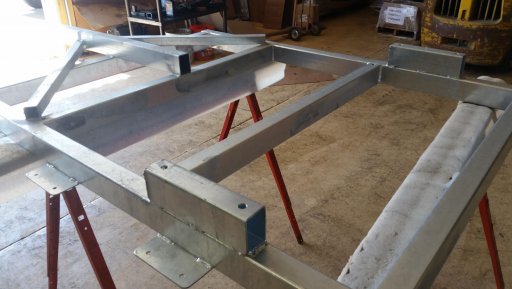

So I spoke to Todd @ Space Trailers today.... REALLY nice guys. Did you know the guys who own Space invented roller blades!!! crazy.. anyway they gave me some specs on the trailer. Sounds like they make an offroad version now that has a firmed up base as well!
Looks like for about a grand I can get 3x 15 inch wheels with new tires, 3x longer space bars( top rack) and the upgraded frame and torsion axel.. right now my frame is made from 1 1/4 inch steel bar the new one is much more robust ( pics below)
I'm thinking this gives me the height I need and makes it much more sturdy over all. Going to see if I can drive up and get it installed soon! its about a 10 hour trip from here to Minnesota I think i'll see if I can find any routes that allow for some camping along the way... take a 3 or 4 day weekend and maybe take the dog with me. Anyone know of any good camping spots between St. Louis and Minnesota?
ArkansasDon
If you can beef up the existing frame (that's if you already have it) by adding more metal then go for that with heavier axle & springs & hangers. Like I said tires 7 rims will make for a better ride. Add shocks will only increase the ride better, especially on them wash board dirt roads. But if you didn't purchase this yet, then go for the heavier frame & other upgrades. Road shown a prime example of gear & how much can be used. Like I said before make this "for you" & the intended use.
