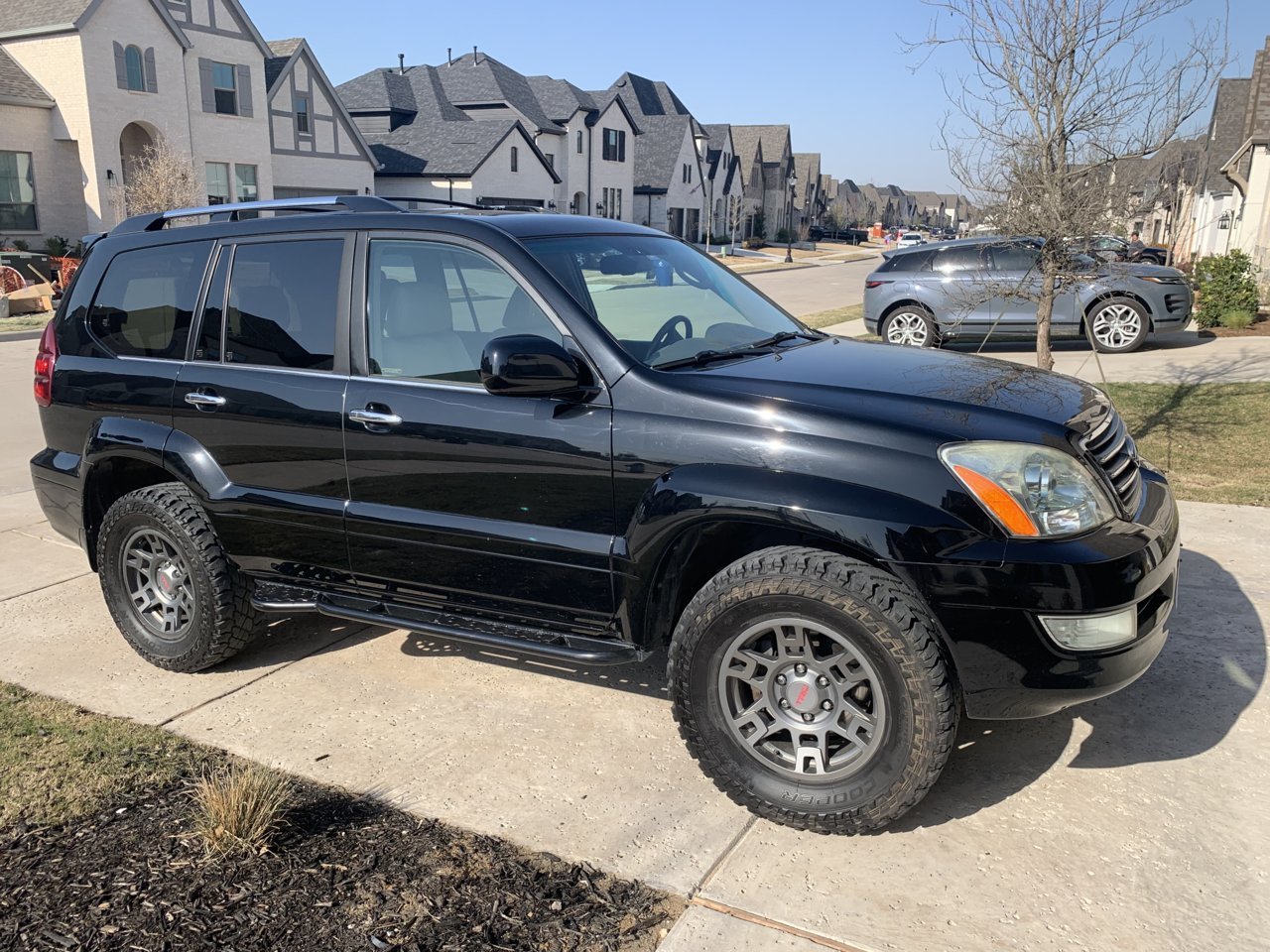

Prado 120 is a GX470 in North America. I owned a 2008 GX470 and it was great off road. Very reliable and smooth driving on the highway. Mine had auto-adjusting rear air suspension that handled extra weight very well. Not sure what Prado trim level that would be in the UK. I think it is the "Grand" in Australia.
Prado 120/GX470 is well documented top notch off-roader. I would YouTube search both models. There are lots of Aussie videos about the 120 and US videos featuring the GX (buildouts, 4x4ing, overlanding, etc). Tons of aftermarket support. I would not hesitate to buy.
