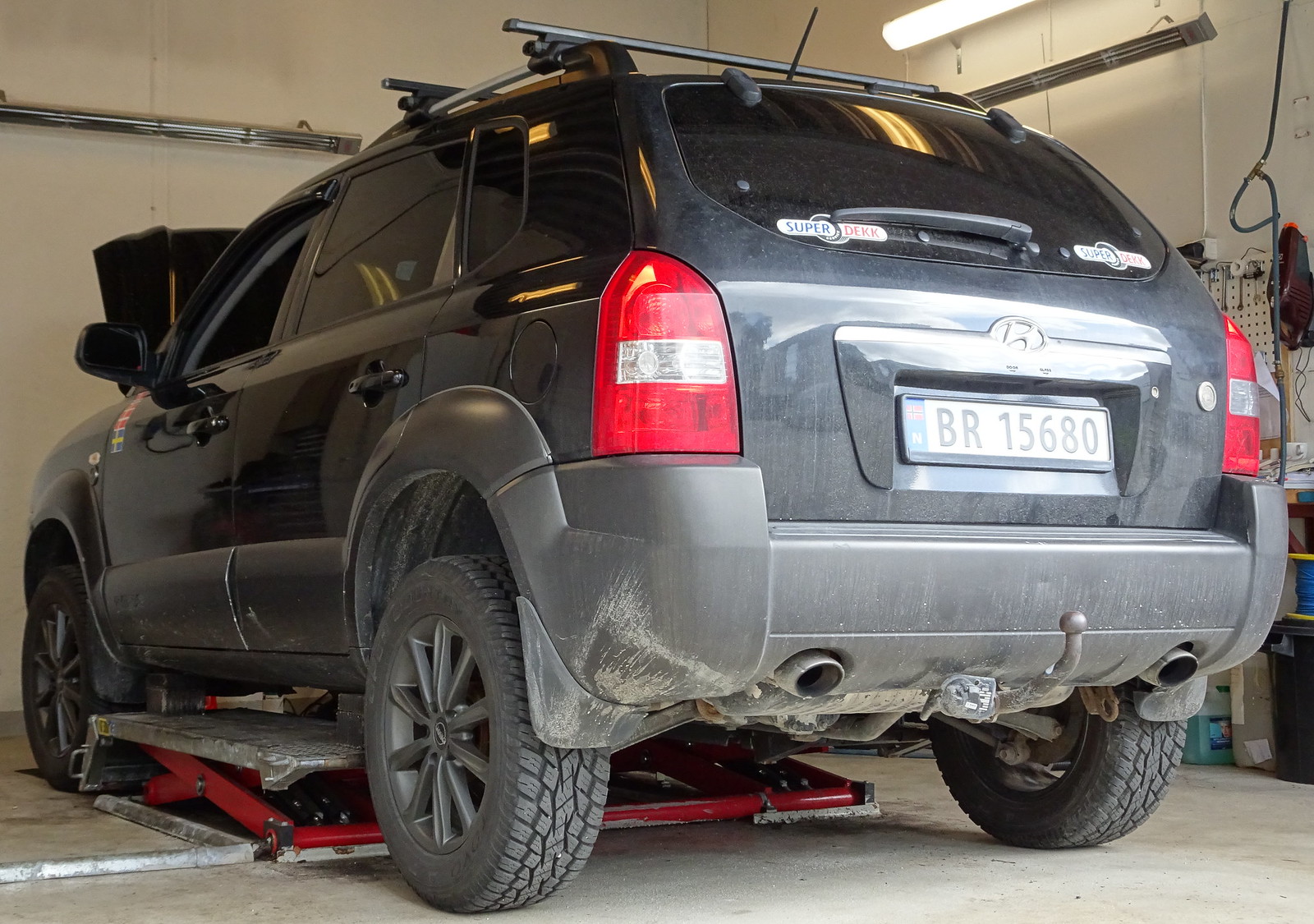

So this is what my crossover would look like with the front lifted 2" and the rear 2.5" sitting on 235/60-17's, not sure what I think about it yet.

Let's say I do decide to lift it, I'd have to save up 3 months for the suspension spacerlift before actually being able to afford it.

I might go for a 1.5" lift instead as a 2/2.5" lift with small tires (28.1 x 9.3") would not look right

I can get it lifted as much as 2.5" front and rear, but I'm still not 100% sure it's something I want to get at this point as it is really expensive for such a small gain.

get the hammer and saw out to make the clearance for the larger tires . going with the bigger lift might affect your CV axles more not worth the extra lift if you have to put in axles more often or make them more vulnerable to breaking
