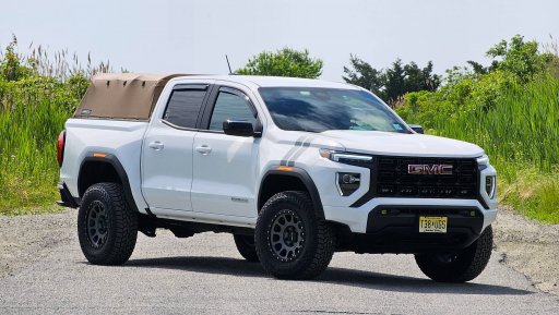

My M/T tires lasted a LONG time. Generally, I think A/T tires will last a bit longer because overlanding often requires putting behind a lot of miles getting from point to point. I ran M/Ts for several years but the first thing I did when I made the change from crawling to overlanding was the A/Ts. I also believe A/Ts are better in sand, but my experience is minimal. My M/Ts dug in like crazy out in the White Sand Dunes near Moab.
Delium Terra Raider M/T, fantastic tire, stuck to everything! lasted a very long time with minimal chipping. 35"
Milestar Patagonia AT/R, more of a road tire although advertised as A/T, great on the road, surprisingly well in the wet muddy sand trails of NJ, never got me stuck in the short time I had them. 37"
Falken Rubitrek A/T, great so far with only a couple thousand miles on them, fantastic on road and on gravel, will have to take them on some more soupy trails to test their offroad capability. 32"

Is the Rubitrek a slightly more tame tire than the Wildpeaks? Something a little more polite on-road if slightly less capable than the Wildpeaks off road?
Yeah, very very similar but slightly more tame. Thinner gaps between lugs, etc. But just barely. They're both 3PMS rated and all that.
