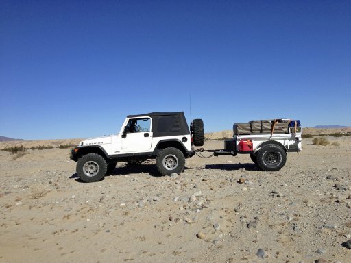

My M-100, when I had the RTT on it fully loaded was 1600#. That trailer (without the RTT) has been dragged over almost every hard core trail on my side of the country. I have run BFG AT's and Falcon...cant remember AT's logging several thousand miles. Out here the rock is volcanic. We shred sidewalls on dirt roads if were not paying attention. My Teardrop is about 2500# loaded and i'm running Wildpeak AT's (they were on sale) in a 235/75 15. This trailer doesn't see brutal trails but has been dragged through rock a few times.
Here's my M-100. I took the tent off but dont have a picture like that.
Which model BFG?

Those are the older BFG AT's in a 11.5 X 33. It was something I had laying around. What replaced them would be KO2's (I think). Really anything with a good AT or mud pattern will work.
