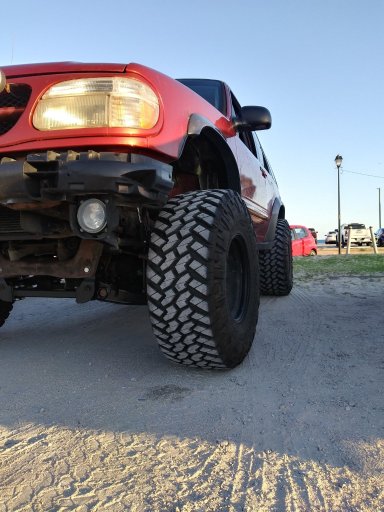

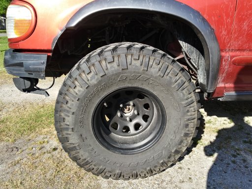

May be check out Nitto's Ridge Grappler tire. That comes in a great variety of sizes.
If you have deep pockets, Mickey Thompson makes some awesome A/T's. Goodyear Wrangler Duratrac's have a nice tread pattern, but that company tends to hold some controversy. Toyo, Mickey Thompson, and Goodyear are all well-grounded in automotive history.
Inspect the tread patterns closely. Generally you want a tire with big, wide-set blocks, and if it has radial grooves, make sure they are zig-zags and not straight (straight grooves run quieter on the road, but slip much more easily on soft or loose terrain). I would concern yourself primarily with tread pattern and secondarily with the tire construction. Check the weight and speed ratings of course, and if you take rocks and roots often, make sure your sidewalls are thick. Some tires have treads on the shoulders.
My tire shown here is a very aggressive M/T, with reinforced sidewalls. Notice the treaded shoulders. This way, if you're aired down, sinking into soft terrain will increase your traction, rather than diminish it.
Also notice the tread pattern. No straight grooves.
I like the tread pattern on those
Reactions: DintDobbs
