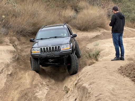

Beadlocks are often tough to balance, and tough to maintain a good seal with. I run them on sand rails and SxSs, but not on my WJ. A lot of people *think* they need beadlocks, when they really don't. A 35" or 37" will work brilliantly on your DJLUR (with a 2.5" lift for the 37") and they give you a ton of sidewall, which means more footprint without airing down as drastically as your 32"s would need to match. I'd say 14-16psi is very safe, and should be all you ever need unless you get into pretty hardcore crawling, at which point I do suggest a beadlock. I'm on a 315/75-16 (~35x12.5") and was at probably 12-14psi in this pic:
Plenty of sidewall flex and huge contact patch, but not at risk of knocking it off the bead slowly working my way through that v-notch.

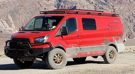

I run Method wheels with "Bead Grip" and my 8000lb van has never had any trouble.
My Nitto Ridge Grapplers are 45 psi on the highway and 25 psi on washboard/rocks, for deep/soft sand I will drop to 15 psi and have never lost a bead.
The key is slow turns and not mashing on the skinny pedal.
I am sure I could go lower psi but have not needed to yet.
