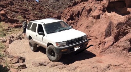

I have 31” Falken wildpeak A/T on my 1997 XE. I have a suspension lift of ~1.75”. They only rub at full lock, and that can be fixed with a heat gun (once I stop being so lazy). They have been great in southern CA conditions.IMG_8726.jpg
