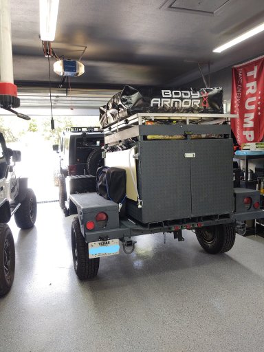

Like I said, started with a military M116A3 trailer. The photo with my white YJ is the raw trailer

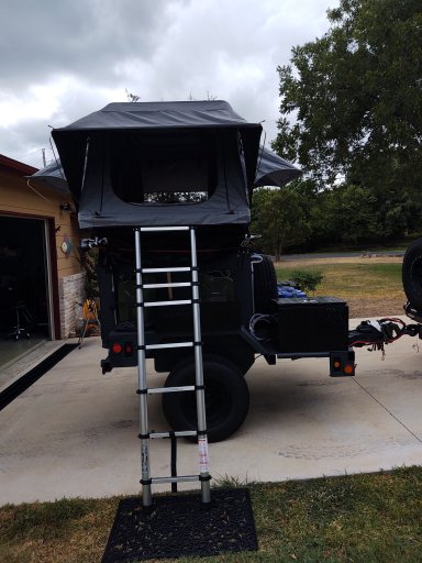

Had an aluminum box built to mount to the trailer, the box has a top rack for storage, and then a top platform for the tent. I went with a Body Armor Skyridge tent and happy with it so far (in the driveway...hah!)
The tent platform is hinged and has struts to be swung up to get to the storage (Of course, the tent cannot be deployed at the time).

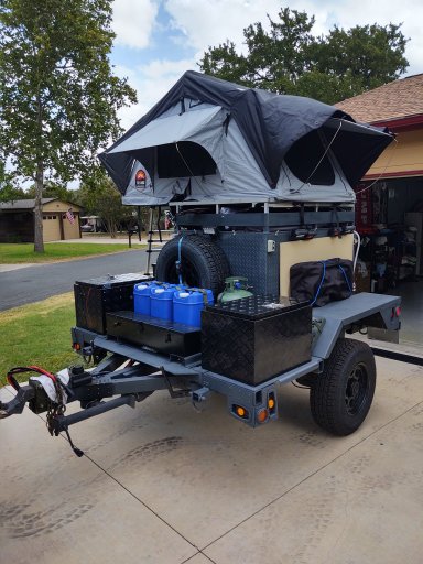

The tool boxes: passenger side box is my electrical hub with charger, dual batteries, solar connection, and Anderson plug to the jeep to a battery isolator. Also has a water pump that feeds a two way valve. One valve heads to the shower hose and the other valve heads to the cooking area on the drivers side. The water is fed from the three 5 gallon jugs mounted on the front.
Mounted flood lights on all sides with both red and white on the cooking side (driver side). The fender on the driving side is the kitchen. Have a 24"x 48" Teflon surface (the tan piece you see on the side) that slide mounts to the side of the trailer and rests on the fender. The toolbox on the driver side is storage for cooking items.
Have a Dobinson cooler mounted inside the trailer on a slide and 12v and 110 v connects inside the storage area to run to the cooler.
