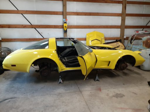

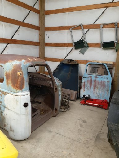

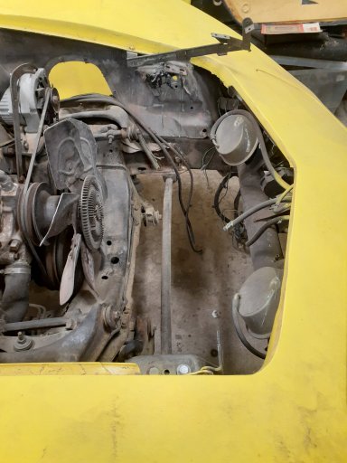

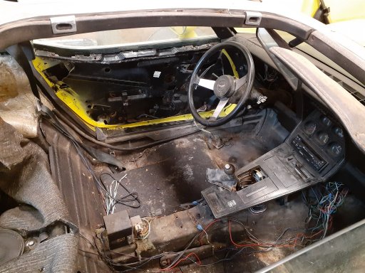

Started making a game plan for lifting the body off of the Vette today. Found some rust in the metal part of the body so now I don't feel so bad about ripping off the body. Here's a few photos of what I'm working with.

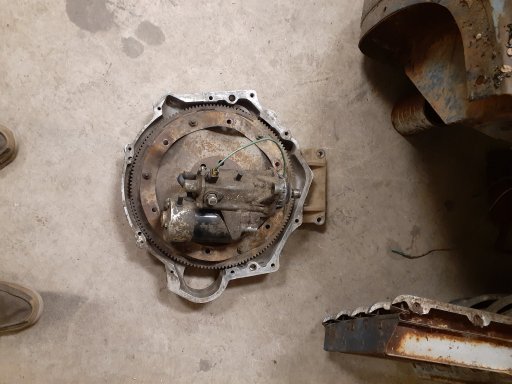

Oh and the parts that will turn this into my dream build, the Cummins B series GM transmission bolt pattern flywheel housing, with a torque converter adapter no less.

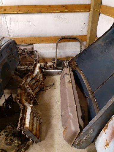

I'm going to have to see how the cab sits on the frame. I would like to maintain the Vette fuel tank instead of running the in cab fuel tank from the pickup. The issue there will be that the Corvette fuel tank is on top of the frame right at the back, where I would want a bed. A lot of this is going to be on the fly. Right now the idea I have is for a wood decked flat bed, with a rack that will hold the canoe.

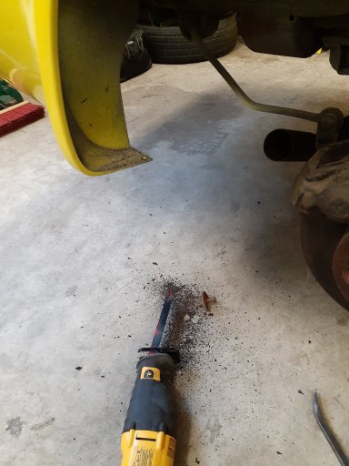

Finally on to the tear down. I got the Vette on stands ripped off the wheels, pulled the hood and got the radiator out. Loosened up the front frame extension and the rear impact absorbing bumpers, pulled the #3 body mount covers and started soaking things down with penetrating oil. While the oil was soaking into the body mount bolts, brake master cylinder bolts and steering shaft bolts I pulled the seats to use in the 49 cab. Got all the cables and wiring pulled from the Vette cab and broke the tires off of the Vette wheels so I can get them out to be blasted and powder coated. Then I started on body mounts. First body mount broke the nut plate free of the body. So I will most likely need to cut out most of the body mount bolts.

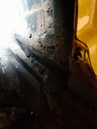

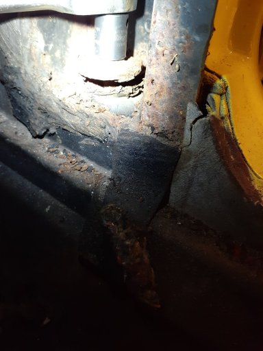

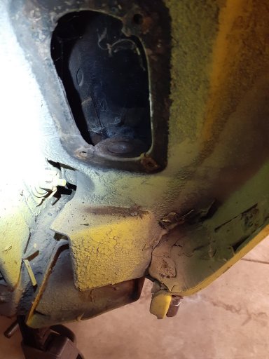

Got a little more work done. The body is completely free of the frame, I just need to figure out how to lift and move it now. The passenger footwell body mount was extremely bad, thank you SnapOn Flank Drive for biting and holding. The passenger side engine body mount was a bear as well. Due to the proximity of the fiberglass body I didnt want to use a torch and heat the nut, and I wasn't able to really get anything in to cut the bolt. So I worked the nut back and forth keeping the threads lubed with oil until the nut loosened up. Then to get the nut the rest of the way off I ended up running a die down the bolt to clean the rust from the threads. On the rear mounts, well saws all solves all.

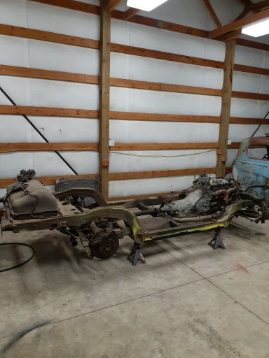

Progress is slow, but its happening. Got the body off of the frame today and loaded on to the buyers trailer, so I didn't even have to deal with tripping over it in my shop, perfect. After that my dad and I set the 49 cab on the frame. I'm going to need to cut out the firewall and make a new on to clear the engine, its insane how far back the engine sits in the frame. The proportions didn't look super awesome, but I'm hoping a set of 33s will change that. Worst case I can always chop it so the cab looks like it belongs better. But who knows, maybe once the hood is in place and some other body stuff is done it will look good. Anyway, on to the drive train stuff...
There’s a guy in my area who put a 1940 dodge pickup on a late model Durango chassis. He dealt with engine setup back as well. Mainly because the taper of the forward portion of the body. The end result was fantastic.
@Dilldog, the frame is not the right configuration for a truck unless you want a low rider. If you want to use it, it could be done by using a flatter tank that dosent stick up above the frame wells and the truck bed sits level with the top of the Vetty rear frame wells.. Something like an early Mustang tank. The truck will make a nice low rider.
