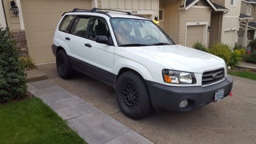

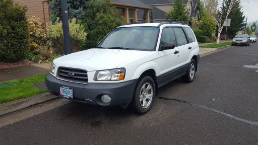

    So that's where this little white bugger comes in . Gresham subaru went above and beyond to make the trade in easier to live with giving me a great trade in amount and a good price on the 03. 125k miles single owner , well maintained 5 speed .
Smileyshaun
2,779
Happy Valley, OR, USA
Shaun
Hoffman
4799

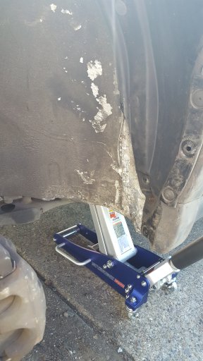

So the good part of the trade in is I kept my wheels and tires. Black rhino boxer wheels and Cooper at3 4s in 235/75r15. now everywhere ive read said i will need a bottom strut lift and probably 4" of total lift to get them to fit. Well after a little massaging .... ok a lot of massaging of the inner fender and pinch weld , a little plastic trimming and remolding they seem to fit . They clear the strut with room to spare , still have a bit more massaging to do and it will need a lift b4 i venture offroad but so far it only has minor rubbing in a few spots . Best thing about the tire and wheel combo is it weighs 45 lbs so even being quite a larger tire there still 2 lb lighter than the stock steel wheel setup. Car feels much more relaxed at freeway speeds now.
