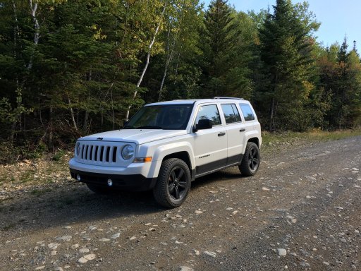

A shot of our pat with it's wheel spacers and 235/65/17 Kumho AT51 installed. These tires are good, but had an odd handling trait where they were very "flighty" at center and slightly off center on the highway.

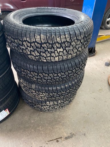

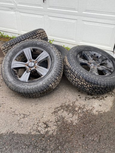

The tires are here!!!!!!!. Bringing the wheels to the tire shop for mount and balance this morning. I will take pictures of all the new gear today. We are installing them tomorrow with a big wrench day. We also have to install a new track bar on my friends LJ. It broke up in the woods. He drove it home. Needless to say it was friggin sketchy on the way back.
