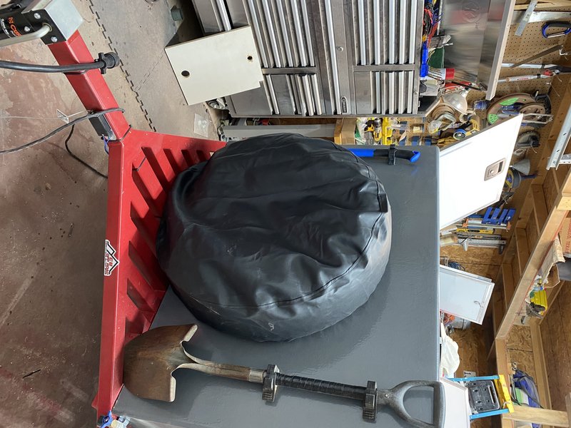

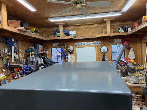

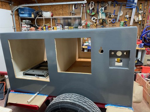

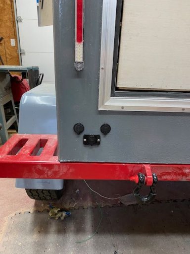

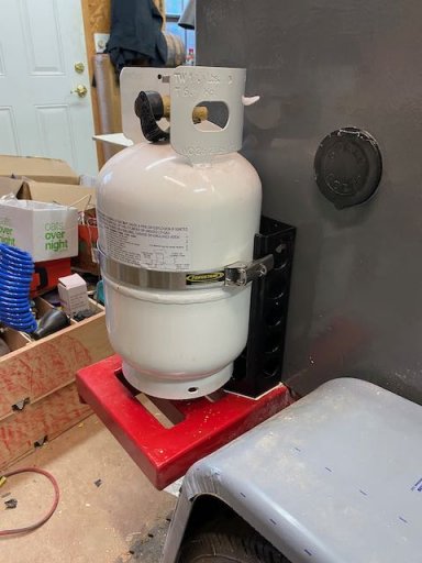

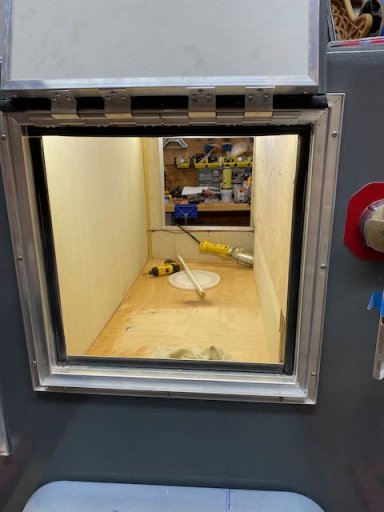

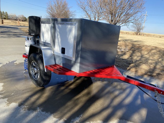

camp trailer build with wooden box. had a local fab shop build the frame, Timbren 3500# axles, electric brakes, ¾ plywood box with three coats of epoxy and three coats of Durabak. 42 gallon water tank, rear galley, getting close to completionIMG_9641.jpegIMG_9648.jpegIMG_9653.jpegIMG_9655.jpegIMG_9642.jpegIMG_9602.jpegIMG_9600.jpeg

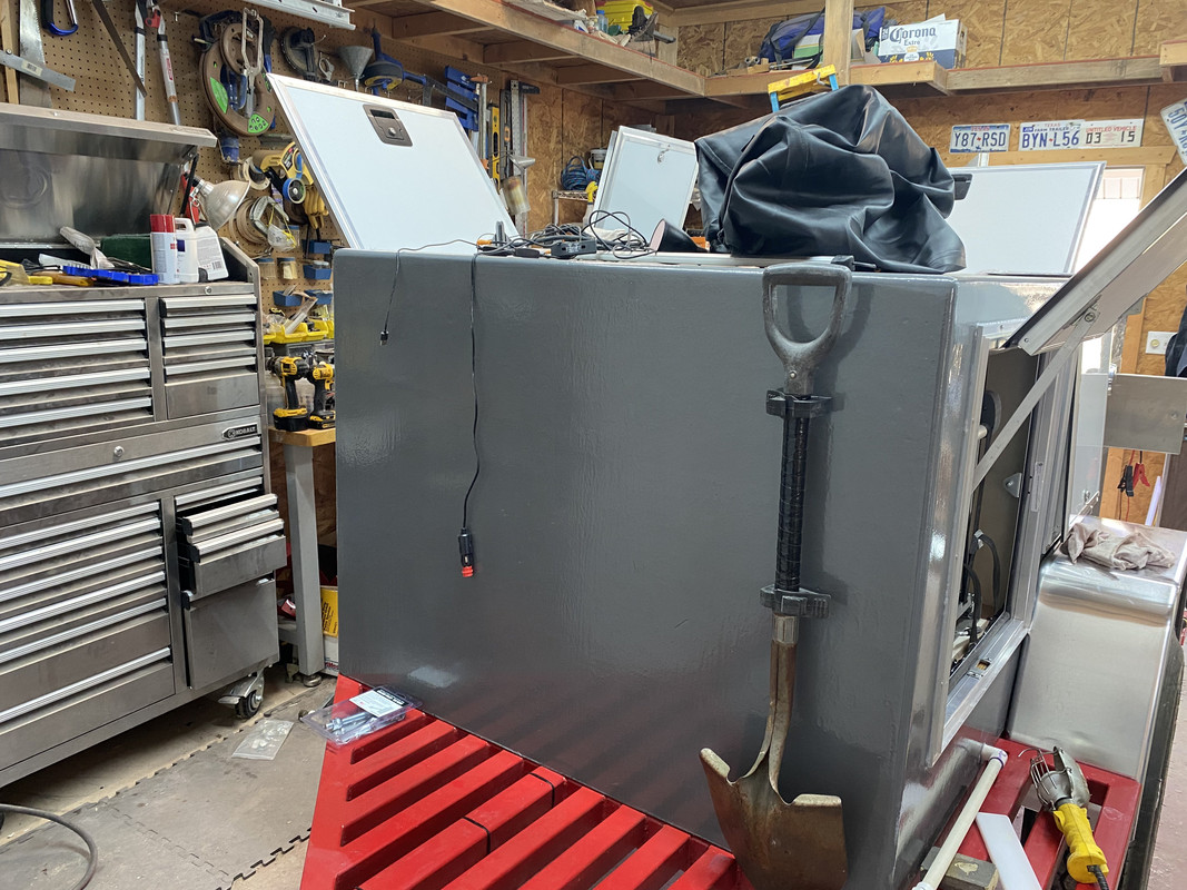

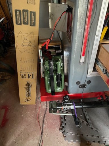

cant use the struts for the doors without head trauma, so i just made some fixed support to hold open.
shovel with monkey fists

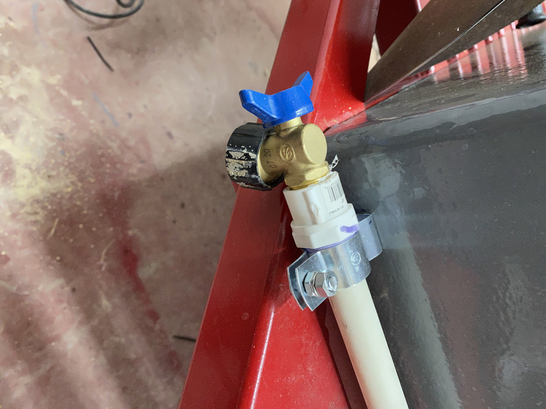

water tank drain and access if no power

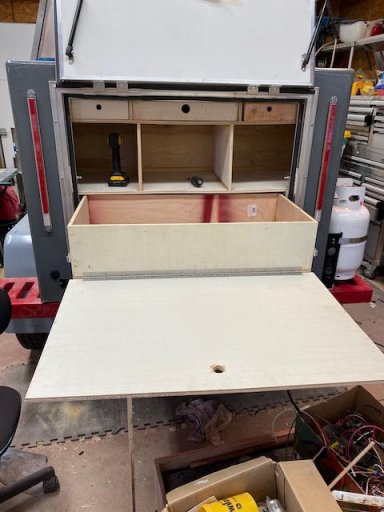

Texas tag and titled done. (not fun) 1700# full of gear but 42 gallon tank empty. so 1700 + 350 water + 50 spare is 2100 # loaded up.

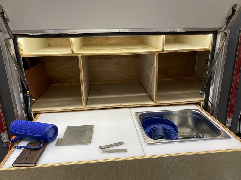

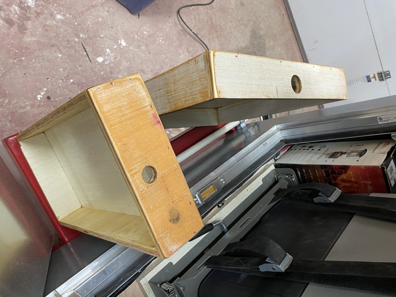

epoxied all the cabinets and drawers and added hardkorr led for galley

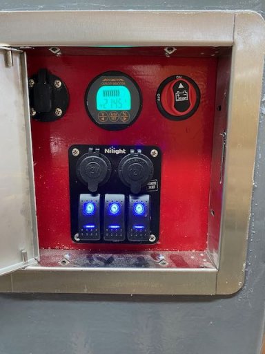

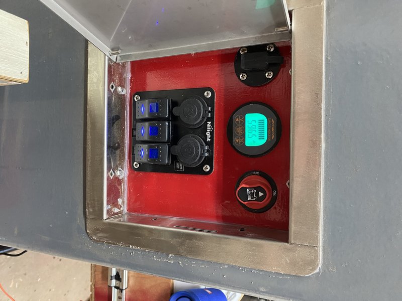

64 ah batteries (16 x4) solar charge port, lights and pump switch
