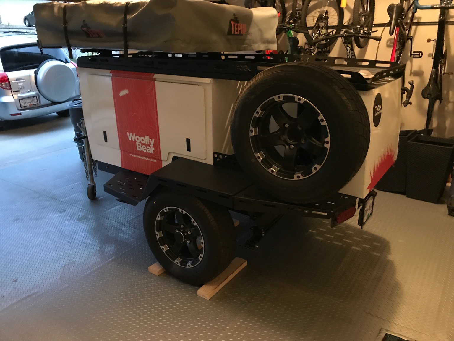

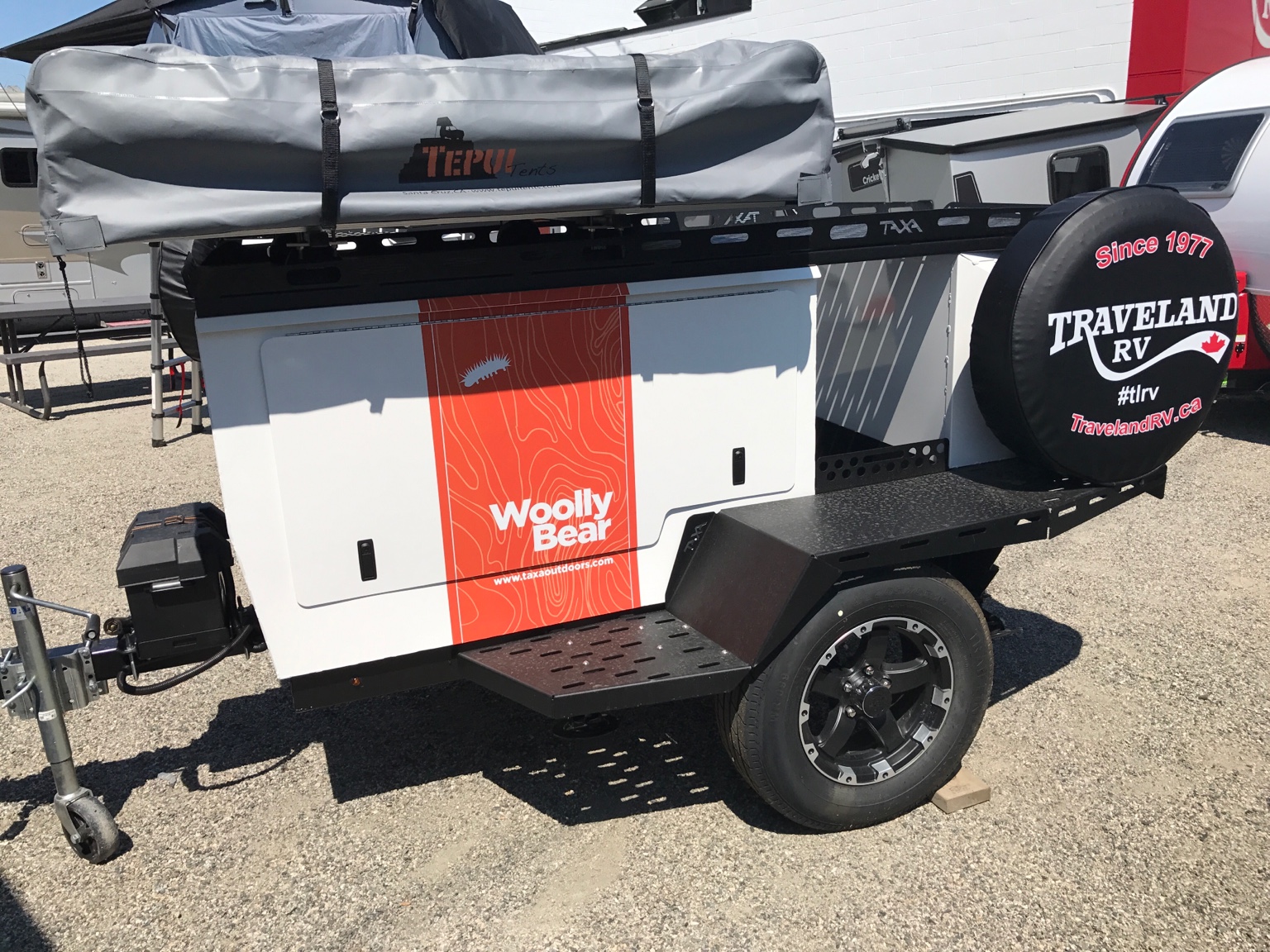

Fellow WoollyBear owner here, so far I am loving mine and with each trip I go on my setup gets more refined. I'm getting close to having it ready to go for trips at all times so it is really enabling me to go camping more easily.
I'll start my own thread once I'm out of forum probation but so far the mods I've made are:

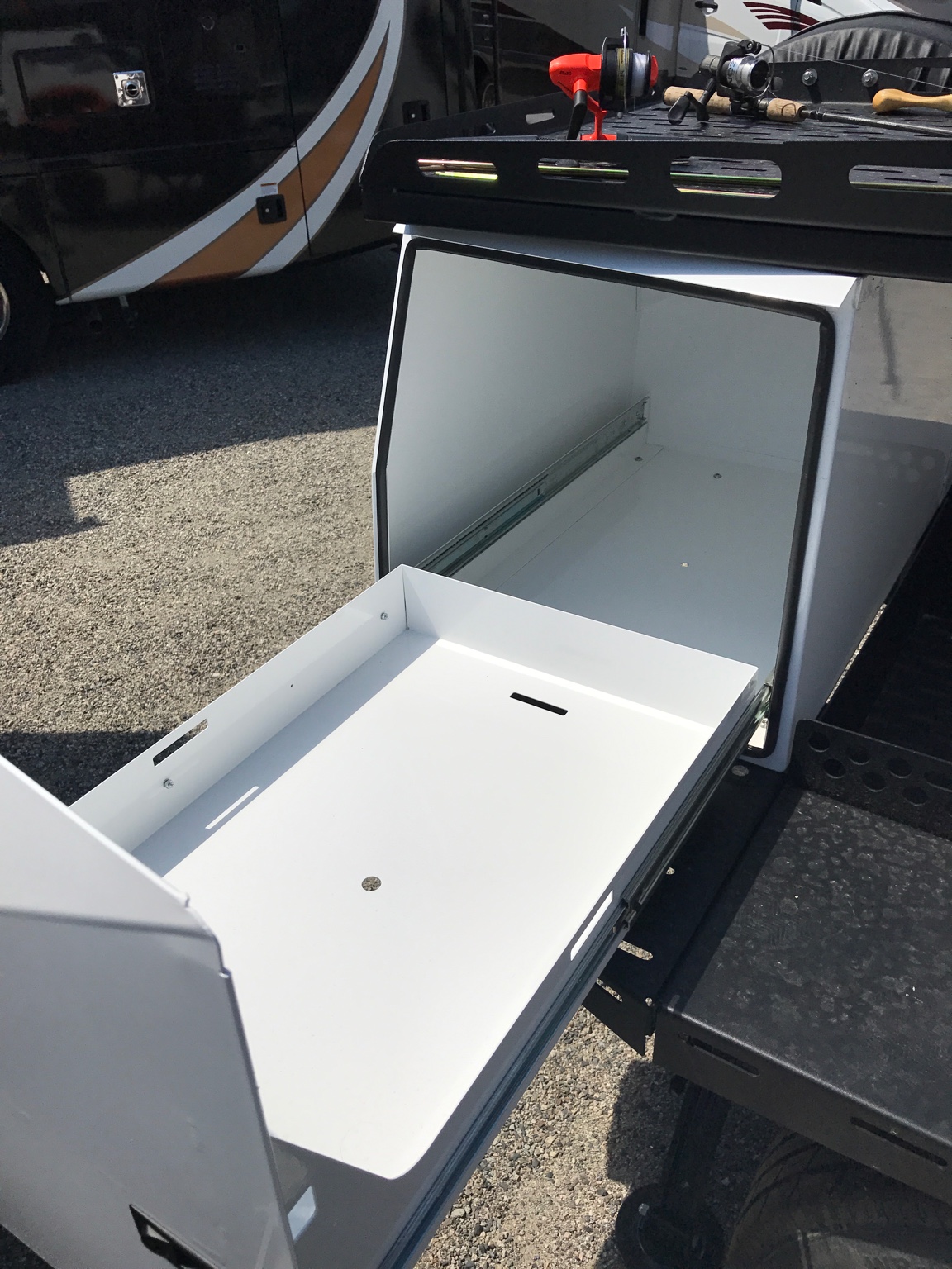

- Ran separate 10ga wiring to the tongue from the rear drawer to power a fridge (Dometic CFX40US)
- Added a "shore power" outlet to run the fridge (swaps power source automatically) when at powered sites or garaged, the quotation marks are because it is just a regular outlet not the RV style
Mods I plan to make:
- Wire in a battery maintainer/charger to the shore power outlet so I have one less thing to do when garaging it

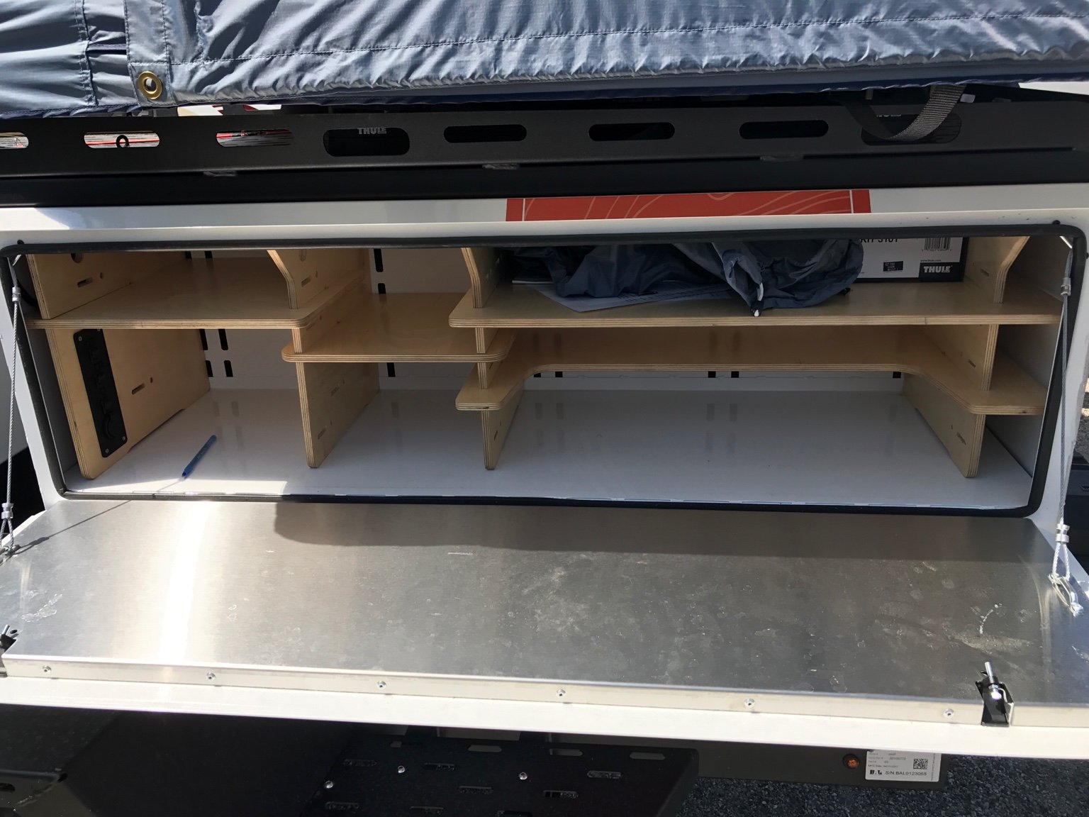

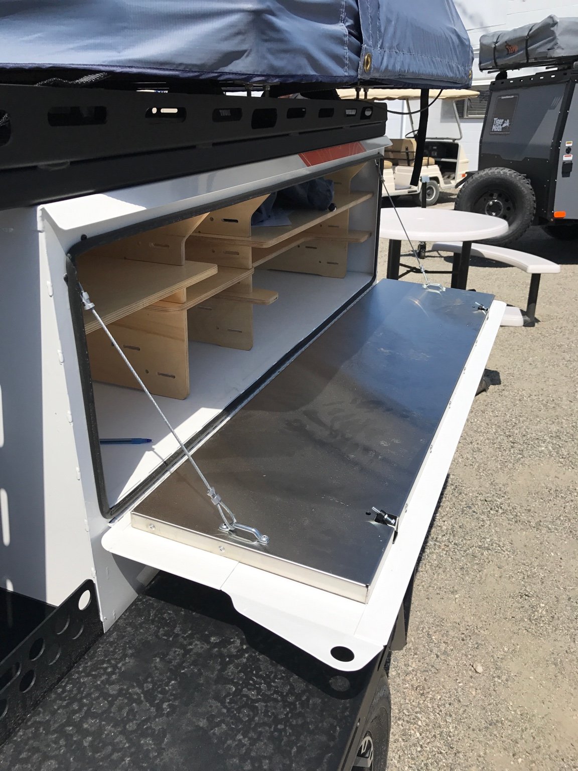

- Add some sort of shelf in the storage compartment like Bueller did

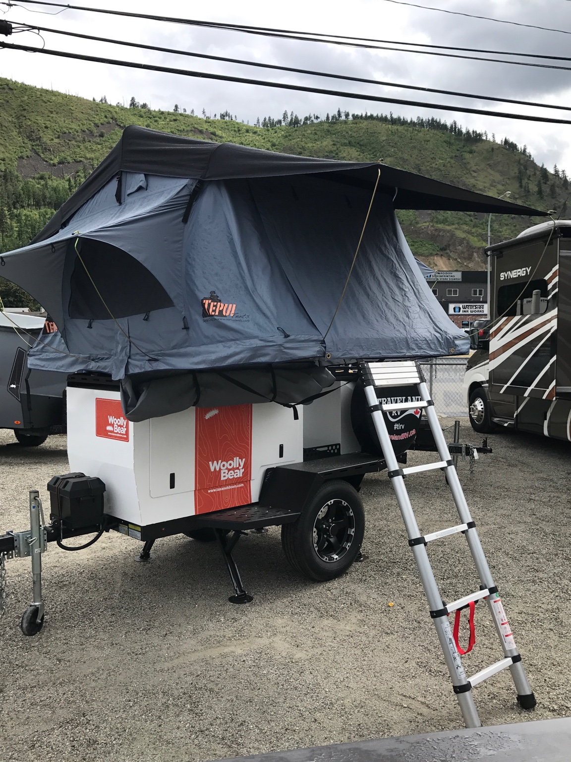

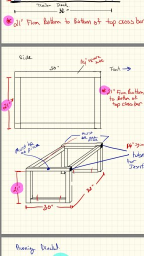

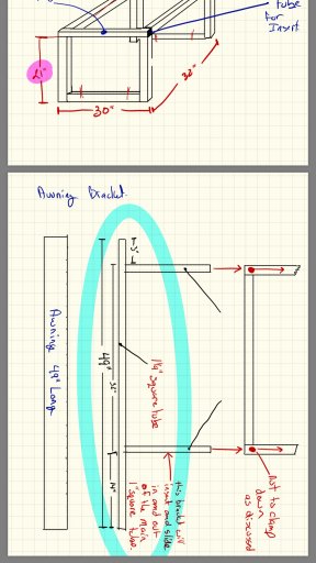

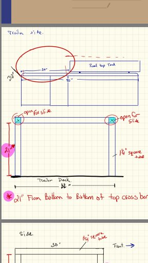

- Work out some way to add an awning over the galley area, current ideas are to either have some sort of lift solution for the RTT and an awning to lift it about 2' above the cargo rack such as something with folding legs and a scissor jack to raise & lower it OR brackets to mount an awning at that height that still allow the full functions of the RTT, which would be tricky to do
- It is booked in to get some BFG AT KO2 LT215/75R15 tires on Thursday as getting a puncture led me down the path of finding out how crappy most Special Trailer (ST) tires are and finding out the tires on there are only rated to 75Mph, which is easy to reach with such a light trailer so I don't want to risk a blowout, the KO2's will also let me air them down on washboard roads to help the suspension a little.
