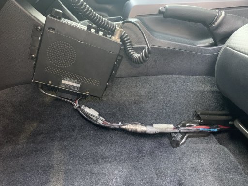

4. Ran coax under seat, along with power cables. I can the power cable through the firewall hear using a hanger.
5. Pulling power cables through.

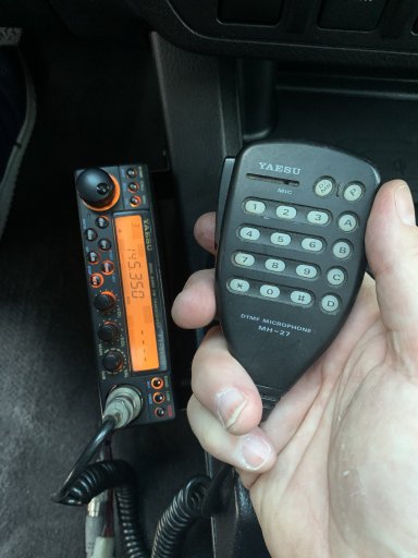

6. Radio mounted and cables cleaned up. I bought some cheap wire loom that I do not like, on my list to redo....
7. Radio.....
7. Diamond Antenna
7. Radio.....
7. Diamond Antenna
