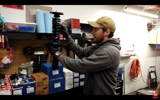

We just did a complete overhaul of our suspension and installed Ceika adjustable coilovers as a little upgrade. The coilovers come with 30 levels of damping adjustability and we have no clue how they should be set haha.
Should the front be stiff and the rear be soft?
Front soft and rear stiff?
Both the same?
On the freeway it seems the rear likes to bounce around while the front (more weight) rebounds nicely...
Then off road the front seems a bit stiff. Body roll all-round seems pretty good but it could be a bitter better.
Any insight would be greatly appreciated.

Uhhh, I'm entirely unsure. Its one single nob on the top of the strut. I'd have to ask the manufacturer.
