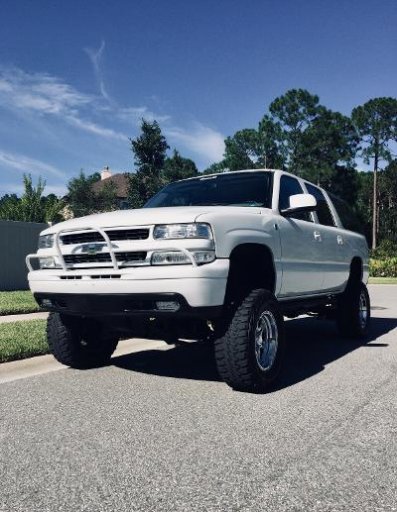

Looks good! I deleted the autoride by putting resistors at each shock and the pump. Tricks the pcm into thinking it's aired up. How much did that lift drop the front diff?
I'm running around 9" of lift on my Burb and it's getting 35s this spring. Here's an older pic, I've changed a few things. Burb 3.jpg

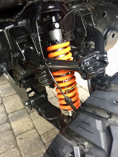

View attachment 78095 Here’s my front setup. Sorry to jack your thread just not a lot of Burb guys here lol.
No problem, I love seeing good stuff from others especially about land yachts. That's a good setup; I don't think my wife would let me get away with a 9" lift.
