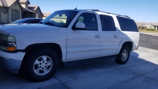

New to the forum. I'm about 3 weeks into a conversion of my 2003 Suburban 4x4. I originally had the idea to build this rig for a Baja California road trip. But I am excited to use this rig for a jump off point for backpacking trips and secluded off grid camping. I already had the suburban, that we hadn't really been using.
It will have the following
Solar setup
120w solar panel
DC to dc charger to recharge while driving.
200ah AGM battery
1200 pure sine inverter.
Kitchen setup
Coleman stove
Microwave/ for plug in camping spots
And for use in inclement weather.
Outdoor solar shower
Full size bed inside (memory foam)
Cartridge toilet for wife.
8' awning
12v fridge
Led lighting inside and out

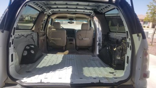

Looks like a great start to a good build. Not sure what you have in mind in the back but, if you are going to do a platform check out using steel grated shelving it is lighter than wood, strong and very fast to install or take out. I like how you stripped it out all you need is two seats right... Mine is the same way but, with my platform I can reinstall them in fifteen minutes if I need to.
Feel free to check out my Tahoe build link in my signature for some ides. If you have any questions let me know... Good luck with your build I look forward to see what you do with it.. Maybe I can use some of your ideas...

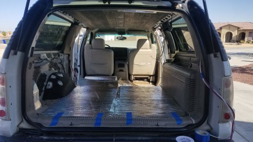

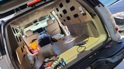

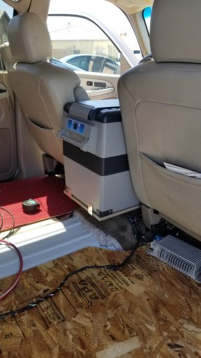

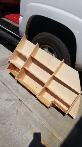

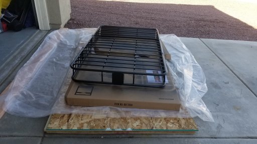

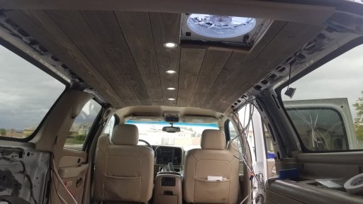

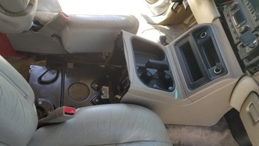

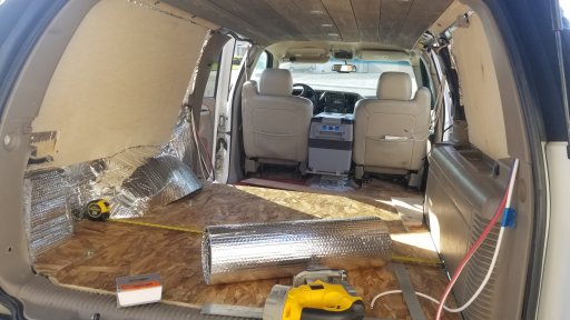

Here are some progress pics. Got the back windows covered and insulated. Put another gland in the roof and ran wires for lights under the side canopy. Installed a roof basket that will hold the solar panel and any future accessories. Got the sub floor in and extended the rear hvac controls to the back of the vehicle ( was located in center console). Those controls, combined with remote start will allow us to turn on the ac or heater in bed for some climate relief if needed. Working on the inside storage shelves now, and the wood working is slow and meticulous.
Trying to get as much done during this quarantine. Luckily Lowes is still open.

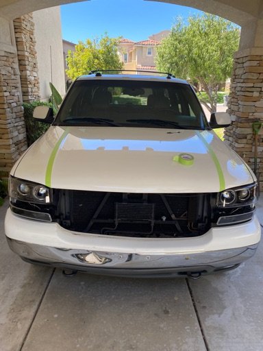

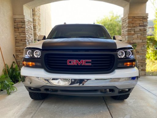

I’m a brand new member beginning a build on my 2004 GMC Yukon XL. Trail ready bumper, Warn winch and PIAA fog and spot lights all getting installed next week. The lift, wheels tires come next after I see how much room if any the new bumper buys me. Just painted the hood and grill with vinyl coating to give it a more rugged look. Hopefully it’ll tie in well with the new bumper. Glad to see there are some other full size truck guys!
