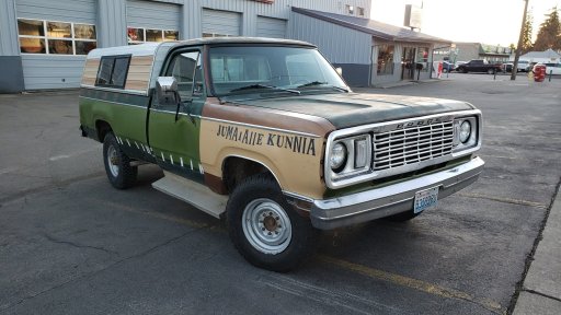

Does anyone else experience lots of side to side rocking when loaded and driving down trails? I am pretty sure my shocks are original. When I hit a bump with just one tire or say both fronts, there isn't much bouncing. The rocking is enough to make me stop and crawl, almost at idle, through the section. Thoughts?

Some more low speed damping will help a ton.
Disconnect your sway bar.

The Dodge, 78 W200, is what I drive. I doubt it has a sway bar. I should air down more often. I am pretty loaded right now, though
I plan on getting new shocks. Do the springs get soft with age? I think coils do, I'd imagine the same principle applies to leafs. I'll look into spring bushings.
I run 235/85R16 tires on 8 bolt steels. Basically stock and I don't intend to change much. I had the truck up on blocks and stretched the suspension; thats what my shocks look like anyway.

Yeah, that's just an empty tube. Try some quality monotube shocks first. Springs if needed.
Bilstein and Fox2.0 are good budget shocks.

Leaf springs do sag over time and your 78 is probably due. You might get sway with some helpers.
But keep in mind the difference between the job of the shocks vs the job of the spring. The spring allows the chassis to absorb bumps that send the wheel upward, while the shock keeps the wheels on the ground instead of continuing to bounce up and down like a bungee jumper.
I certainly agree those shocks look spent. I have Bilstein 5100's and I like them. I dont know anything about offroad voiding Bilstein warranty. I sure hope not. That would be weird. But I bet even any Gabriel, KYB, or Monroe rated for an 8 bolt hub truck would be better than what you have there.

I'd say the shocks might be shot. Springs tend to flatten with age on blocks there is lots of camber, what do they look like on the ground? And new springs will improve everything if yours have lost that camber but the big difference will be shocks which dampen the action and reduce rebound which causes the rocking, you hit a bump with one tire and upset the balance, new shocks stop the rebound. Sway bars only transfer that rebound action to the other side, they have no ability to stabilize the ride, they only control lean when cornering. If anything on a rough road they will make the ride rougher since they transfer the up travel of the wheel hitting the rock to the opposite side. The smoothest ride I ever got was in an old Econoline pickup, it had no sway bars, incredibly tiny light 14" wheels and plenty of wheel travel. You could drink coffee crossing a freshly plowed field. Get new shocks, even the cheapest NAPA shocks will make a huugggee difference.
Gorgeous Dodge, I had one when it was new.
