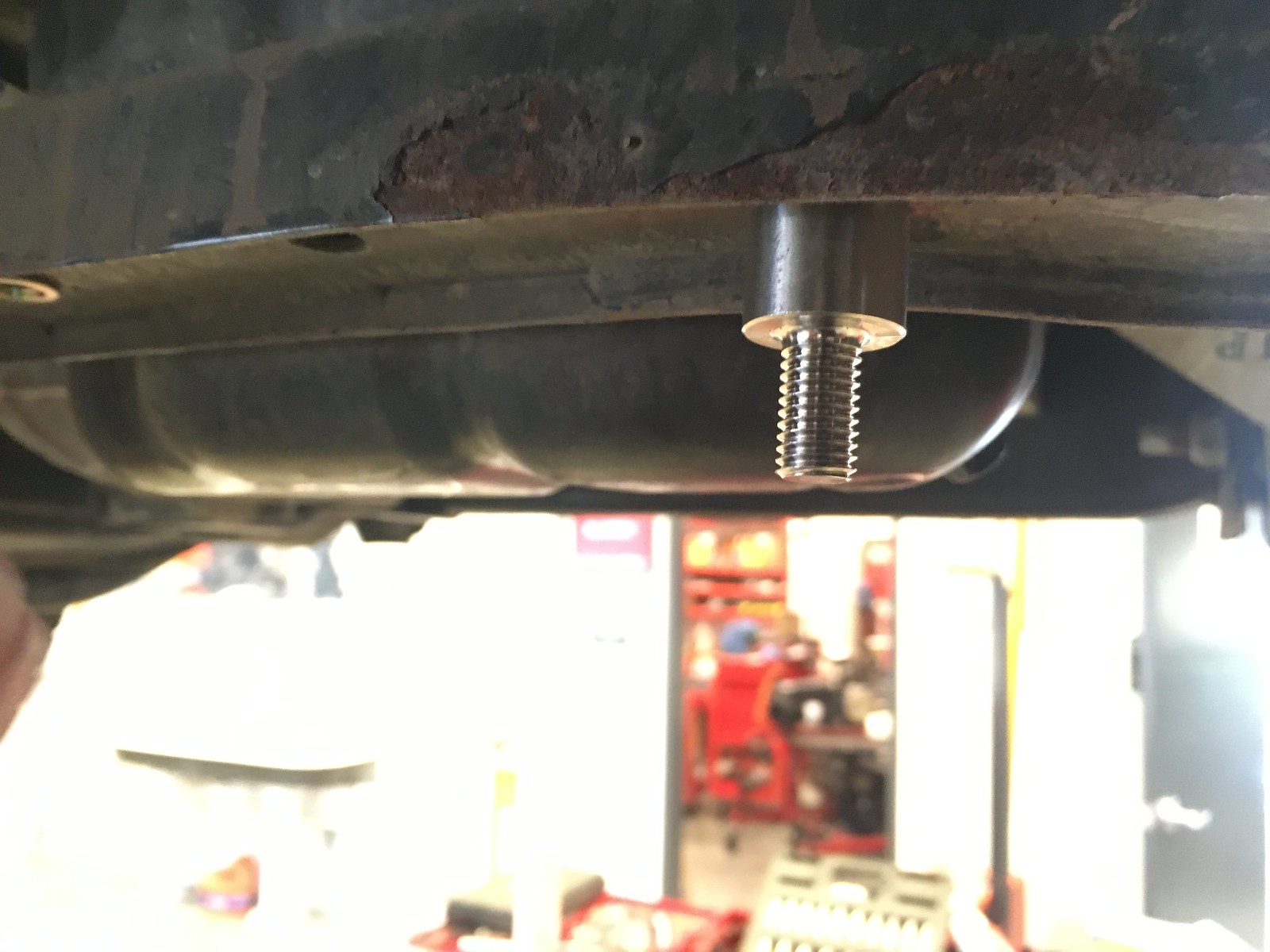

At this point, you should take the set of SPC 87520 camber bolts that you have for the rear toe adjustment and using the thread die, cut another ~1/2” of thread onto the bolt. Then, leaving the die on the bolt, shorten the bolt by a corresponding 1/2", file the nose down so its tapered a bit, and back the die out to clean up the threads.

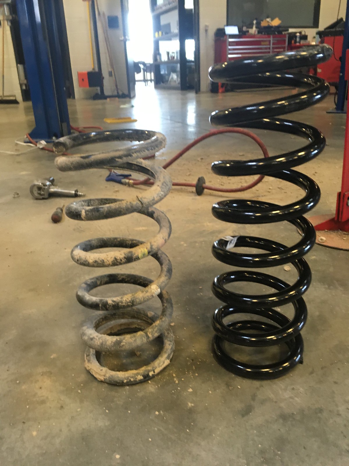

This is where shiz gets real! The OME 2986 spring is about 4.5” longer than the stock spring (results will vary here depending on how worn your springs are) and has 2mm thicker bar. There is no way that we could find to get the new spring into place without compressing it about 3”. At this point, I feel obligated to say that is you are in any way uncomfortable with compressing a coil spring that much, I don’t blame you. Take the vehicle to a shop and have them install the lift.

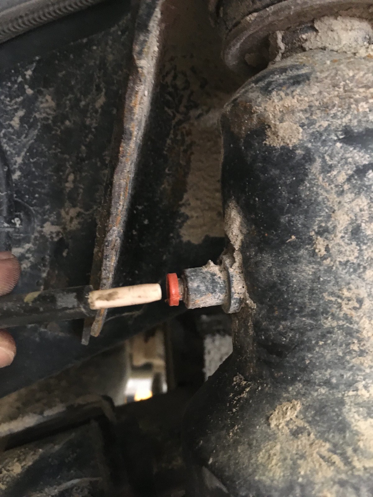

Next remove the air line from the shock. You do this by pushing the red ring towards the shock body with a flathead screwdriver, then pulling the air line out. This will cause a rush of air as the shock deflates.
![](/forums/proxy.php?image=https%3A%2F%2Flive.staticflickr.com%2F65535%2F51139439620_4e035008eb_h.jpg&hash=c3ea57e99077385552f6c48d9a6b6955)

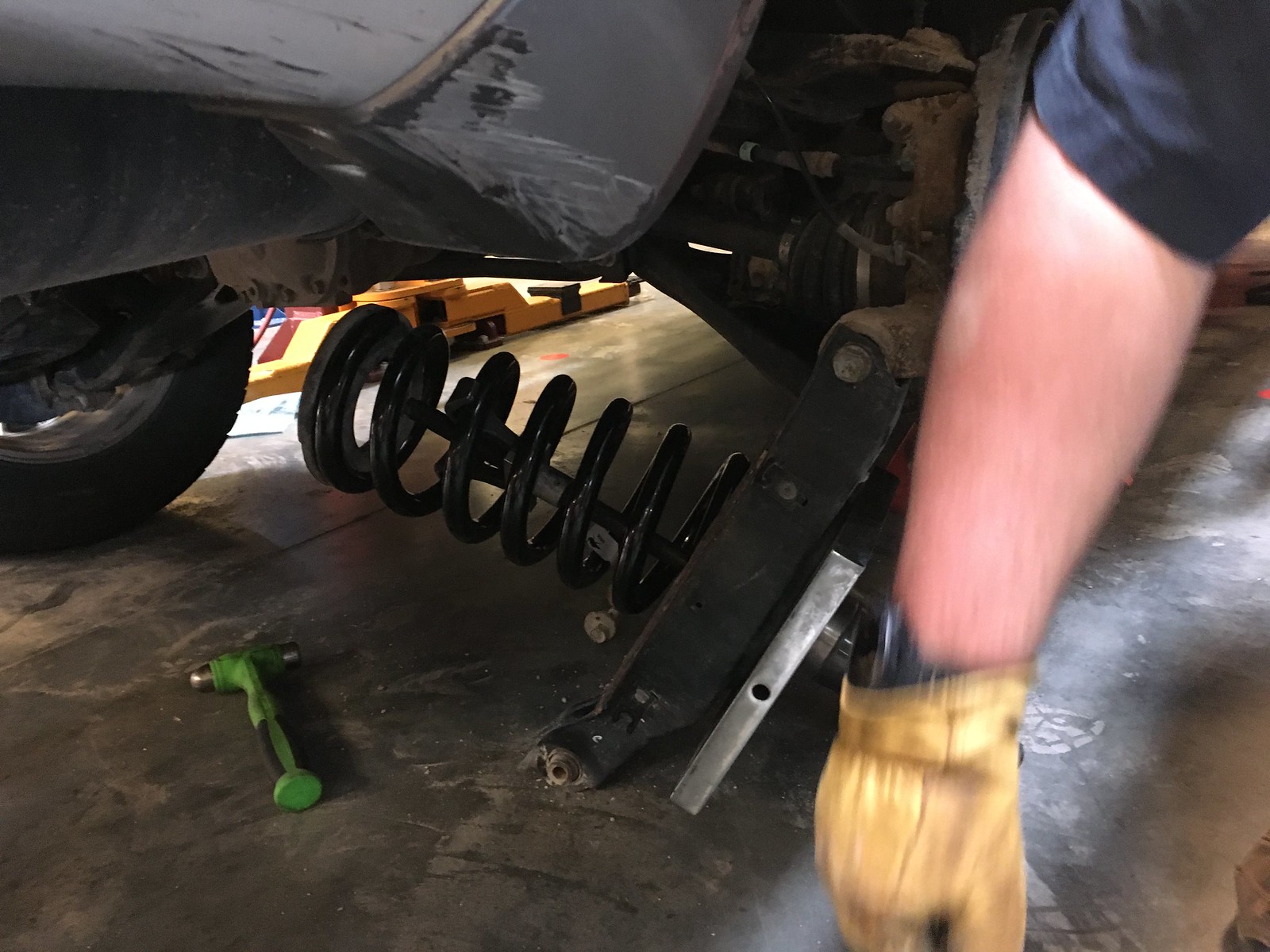

Slowly lower the jack until the spring is free and pull it out.
![](/forums/proxy.php?image=https%3A%2F%2Flive.staticflickr.com%2F65535%2F51122861157_a4272efbf5_h.jpg&hash=7371f4f65c8d0ec4c725ed1c590c1d8d)

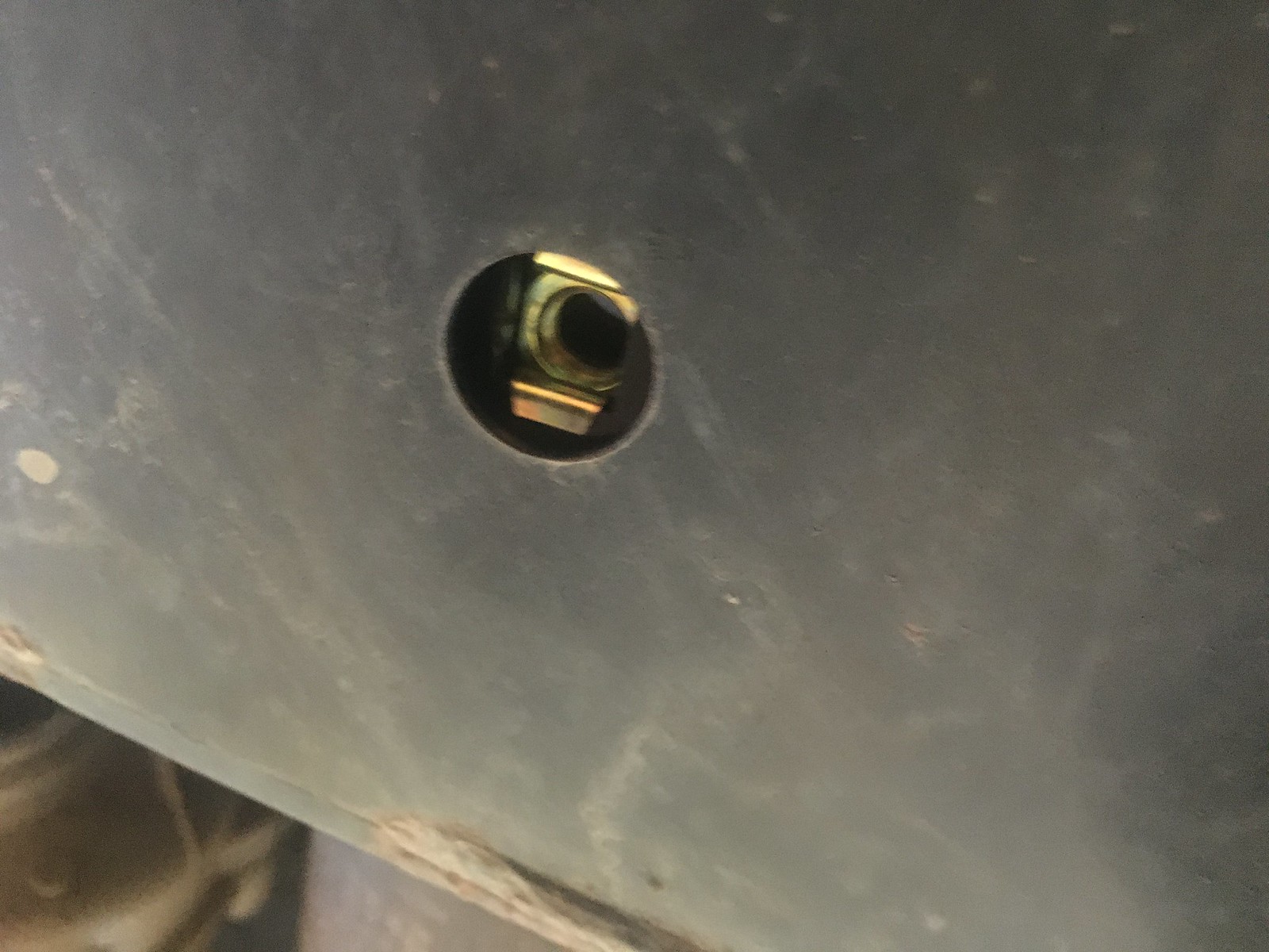

![](/forums/proxy.php?image=https%3A%2F%2Flive.staticflickr.com%2F65535%2F51138762729_eb12bed03d_h.jpg&hash=dd27ceef0a675d04a025dc176c9c76ad)

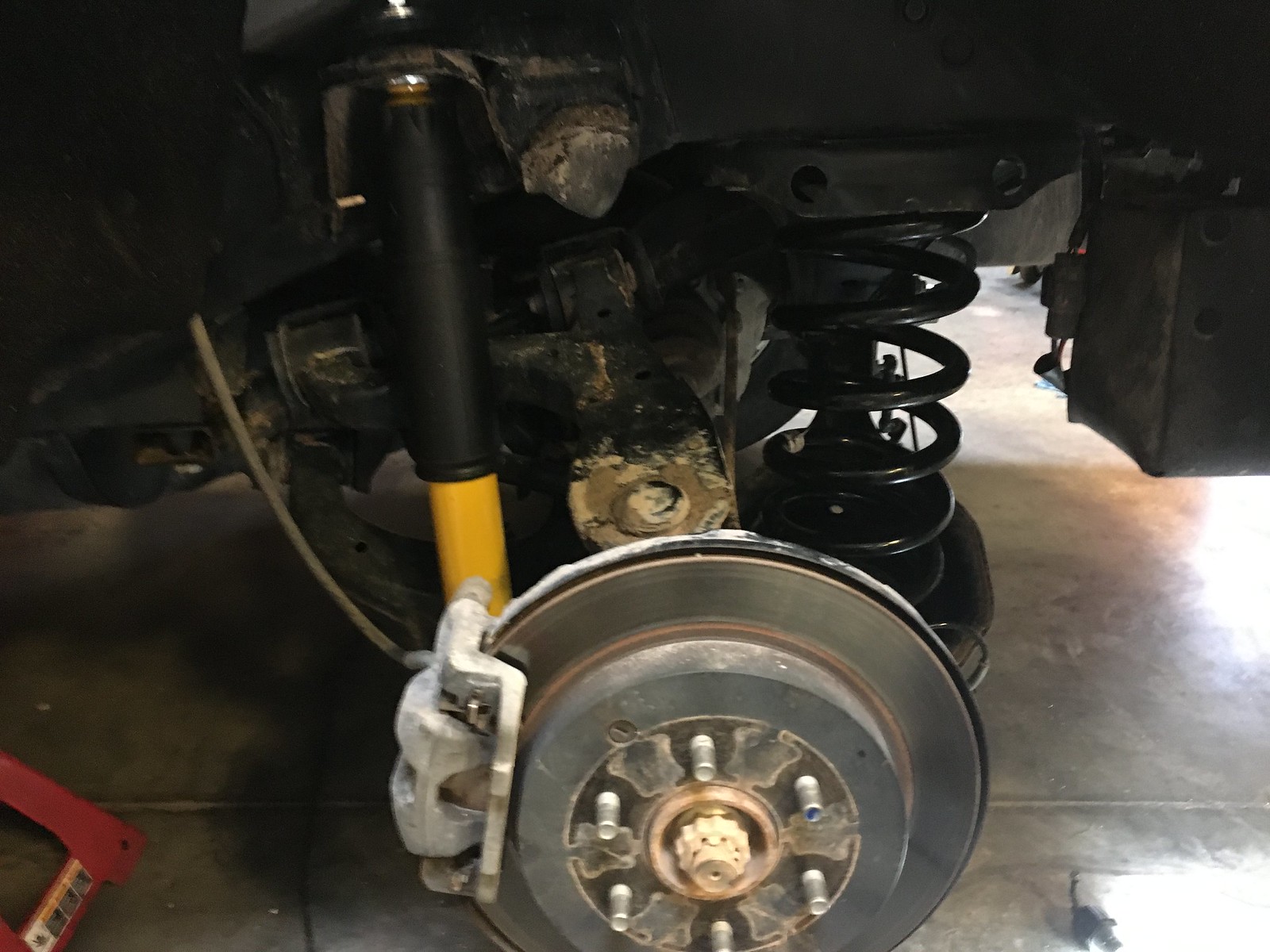

Then install the new shock, which is just the reverse of removing it.
![](/forums/proxy.php?image=https%3A%2F%2Flive.staticflickr.com%2F65535%2F51139092940_387125c755_h.jpg&hash=eeb570e4c78cafe431e3d8247c69dbd7)

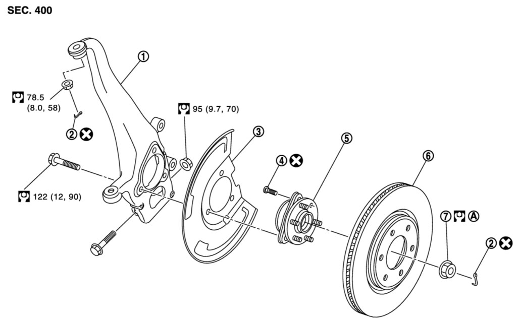

Next, you basically have to dismantle the rest of the front end. You’ll need to remove the steering knuckle (I hung the knuckle from the frame so I didn’t disconnect any brake lines):
![](/forums/proxy.php?image=https%3A%2F%2Flive.staticflickr.com%2F65535%2F51138739588_362cecb17b_b.jpg&hash=015bcbba02b4a8bbe58a38b885f408ec)

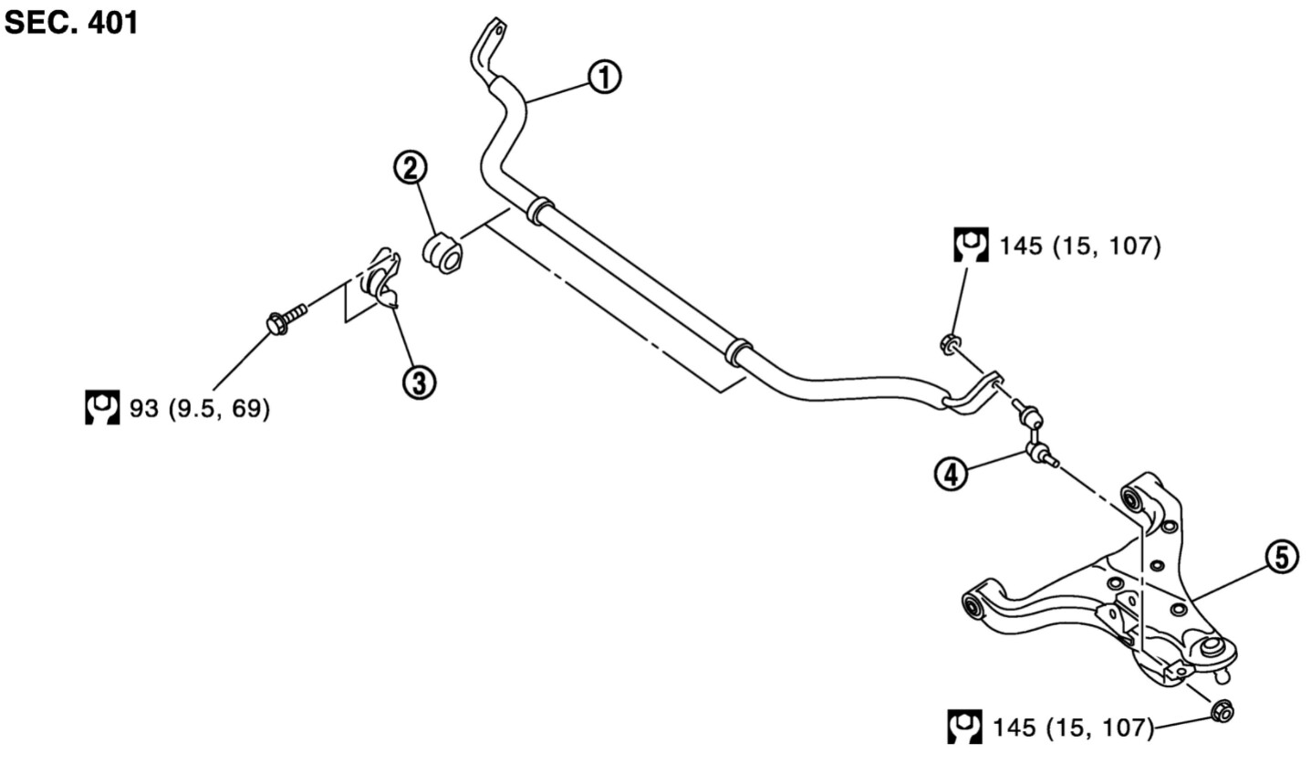

The sway bar:
![](/forums/proxy.php?image=https%3A%2F%2Flive.staticflickr.com%2F65535%2F51138747768_3a7a56ad42_h.jpg&hash=f8eada2da34222a171db070798a0019f)

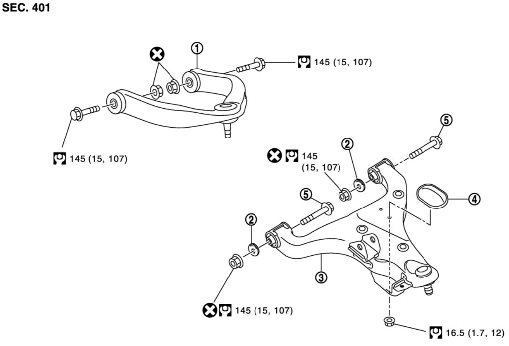

And the upper and lower control arms:
![](/forums/proxy.php?image=https%3A%2F%2Flive.staticflickr.com%2F65535%2F51137844727_2dacbdd1ab_b.jpg&hash=5413f4f0aff02c3f35ffdeb9ffc65164)
Once you have done that, take your new SPC 25560 upper control arms and mock them up in place. Let the arm hit the upper strut tower and mark where it hits and then using your preferred tool, notch the tower so the UCA has maximum range of motion.

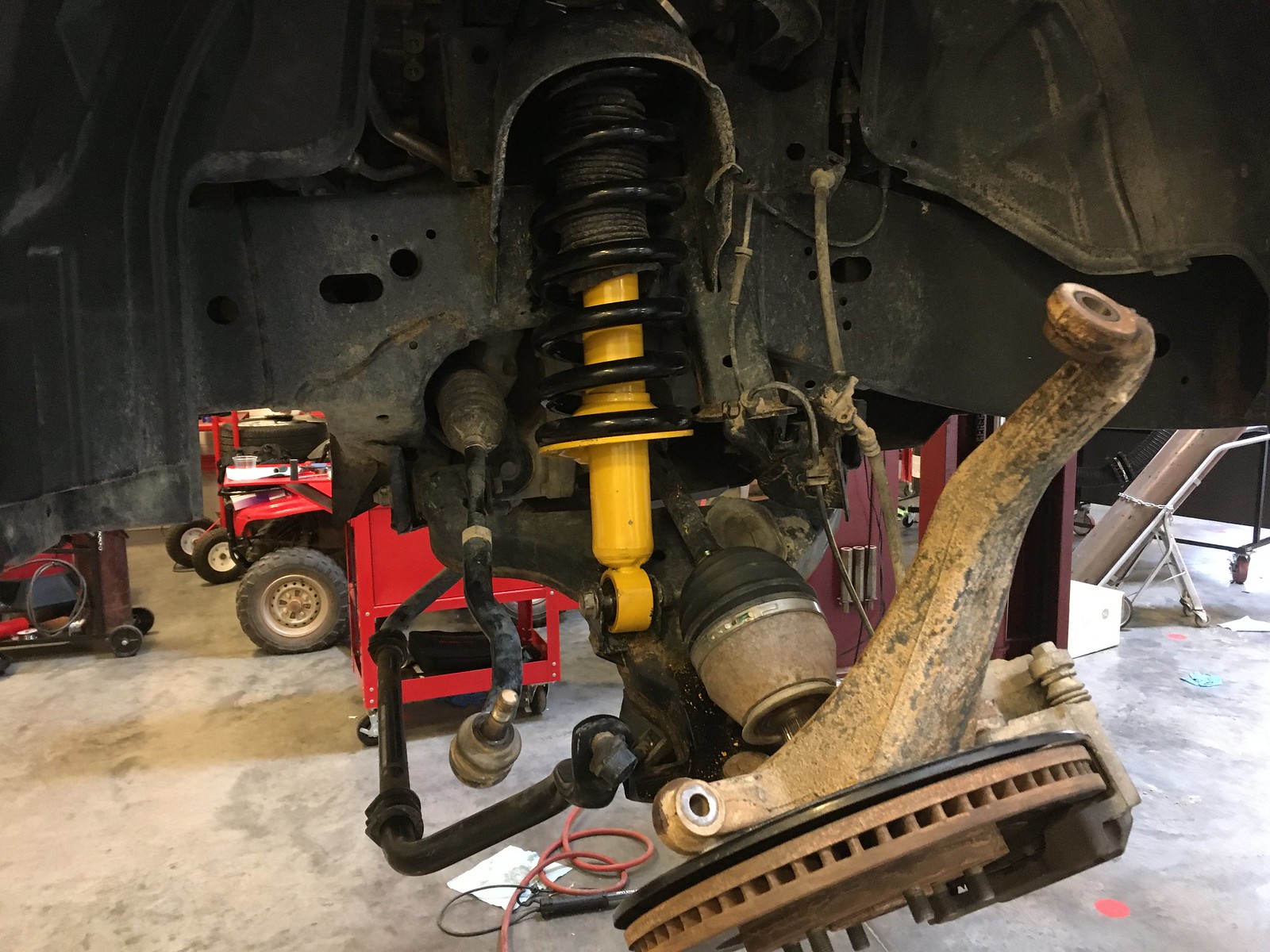

Put the new strut into the upper strut tower and loosely reinstall the nuts. Then pull down on the LCA so you can fit the lower eye of the strut into place and install the bolt. Snug both the upper nuts and lower bolt.
![](/forums/proxy.php?image=https%3A%2F%2Flive.staticflickr.com%2F65535%2F51138205773_c95c71ecba_h.jpg&hash=fb71a77a667cc49a93be11a16f94b6e4)

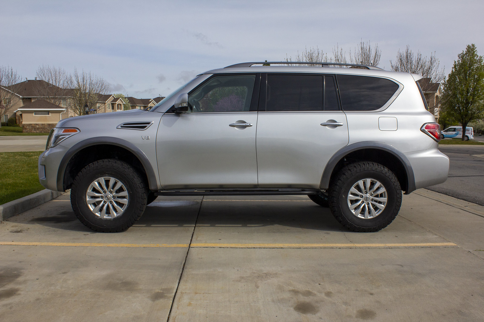

And you’re done!

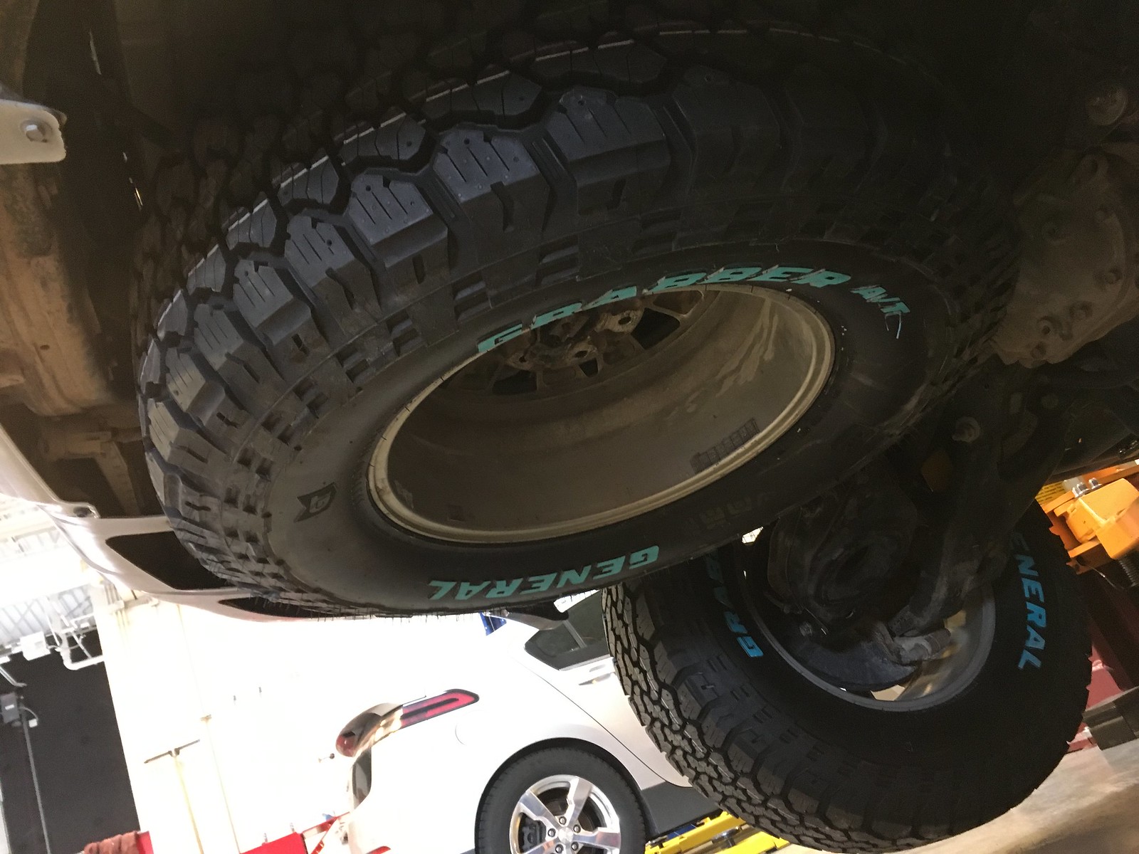

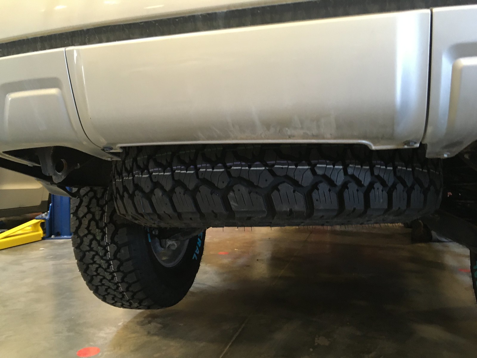

Spare Tire:
I’ve read in a couple places that you can’t fit a 35” tire in the factory spare location, this is incorrect. You can indeed fit a 35” tire there easily.
![](/forums/proxy.php?image=https%3A%2F%2Flive.staticflickr.com%2F65535%2F51137986201_63b1c67d2c_h.jpg&hash=0172f4b136b4307970229b4d169ddd57)
![](/forums/proxy.php?image=https%3A%2F%2Flive.staticflickr.com%2F65535%2F51137986241_6131315698_h.jpg&hash=c988bcb77d19187101de0b7b3664075b)
