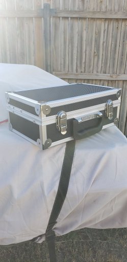

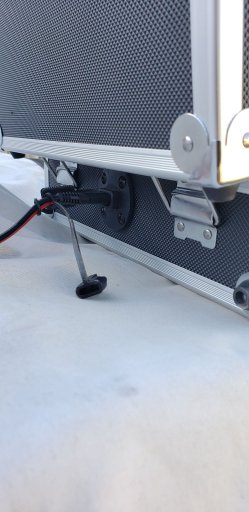

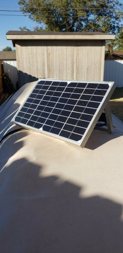

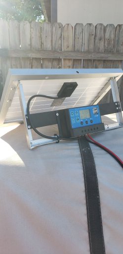

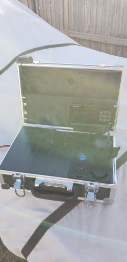

I scored a Sirius Radio, and purchased the vehicle kit. Mounted it in a aluminum box with some kydex panels. Added a 9ah battery, some usb/12v sockets, volt meter and a switch. The radio is connected to a bluetooth transmitter, so I can pair it with my portable bluetooth speaker. Got a 10w solar panel, and had to fab up a stand, and mount for the charge controller. Slapped on a SAE port and cable and viola!
Portable, Solar powered, bluetooth enabled, Sirus Radio! Took it out camping last weekend, and it worked great. As long as you've got a clear view of the sky, you have music.
I know its not the prettiest thing, but this was more of a prototype/proof of concept. The next build will hopefully look a lot better.
