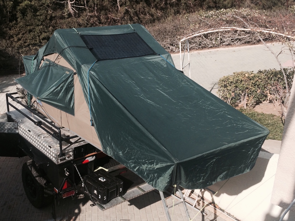

So spending the morning looking at ways to mount the solar panels with the roof tent set up.
Looking good so far but needs a little refinement but 1 panel each side of the apex on the tent and I'm charging away.
Happy days.
So how do you do yours?
Happy days.
Hey shipmate, where do you get the solar panel from and what are you using it for? topping up the car battery? charging toys and gadgets? etc etc.
