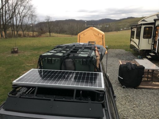

Do not buy some crazy expensive portable, all in one or any of that crap. Get on Amazon and get a newpowa solar panel. A little less than a dollar a watt, 50watt would probably suffice or get a 100w. I have the 100 watt mounted on my gobi and it produces 99watts at the meter under full sun. That’s about $80 bucks, then get the smallest mppt charger you can find, 20 amp or less. probably a Renogy and your set. Aside from some wire. A lot of solar kits or overland marketed kits are just getting your money cause there wayyyy over priced. If you pay more than a dollar a watt your a fool. My dometic pulls 53 watts for about 2 minutes every 15 min. So 50-100watt panel is more than enough. You can add 100watts of solar for less than $200

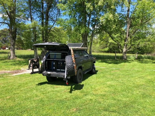

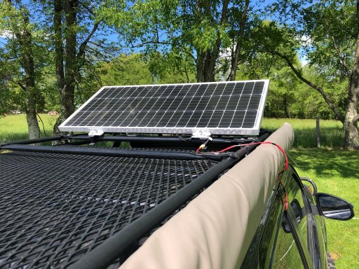

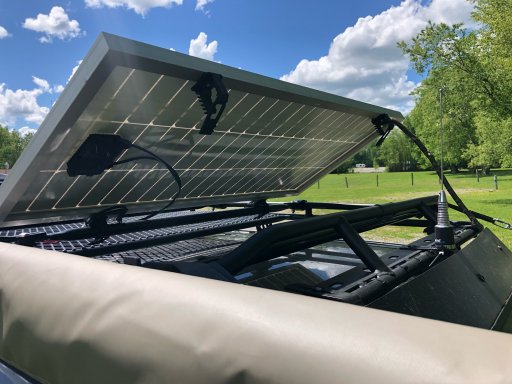

I use the same panel on the roof of my Land Cruiser to keep my house battery topped off.
The Renogy 100w panel with a Voyager charge controller has no problem maintaining a charge with the fridge running. I am pretty sure it could run the fridge indefinitely with good sunlight everyday.

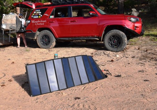

We've been using the Bugout 120 from Overland Solar for a few years and are really happy with it. Our advice, according to your needs you stated in your original post; definitely get a portable, solid or foldable, and a long cord. You said you need to help keep your battery topped off when parked in camp. I don't know about you, but I prefer to park my vehicle in the shade whenever possible. A panel permanently mounted on the roof or hood will be very inefficient in this scenario. Any panel will work best when out in full, or the most, sun and angled towards it.
