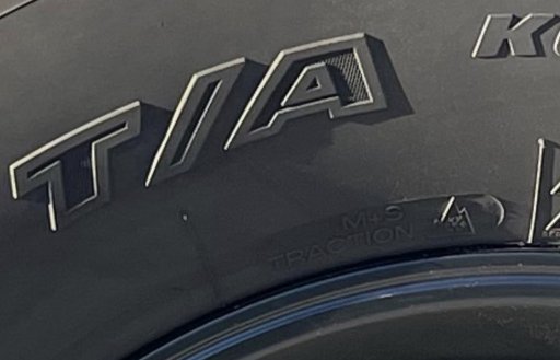

1 Snow-tread Tires: The California Vehicle Code, Section 558 defines a snow-tread tire as follows, "A 'Snow-tread tire' is a tire which has a relatively deep and aggressive tread pattern compared with conventional passenger tread pattern". Snow-tread tires can be identified by examining the sidewall of the tire where the letters MS, M/S, M+S or the words MUD AND SNOW have been stamped into the sidewall.

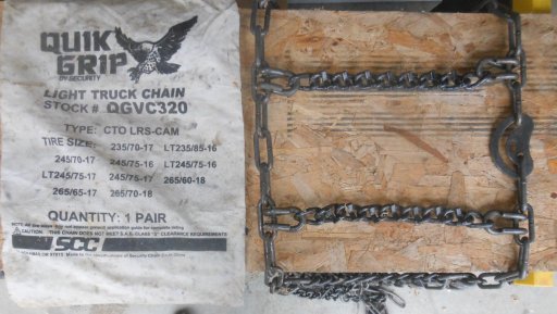

if you are talking about the 4Runner, I have you same exact truck and tires setup. I'm also in the process to get a set of chain for when off-roading this winter. I did some research and I think I'm gonna go with either
Peerless Auto-Trac
or
Security Chain Company Quik Grip
Probably the second ones, they seem a bit more heavy duty.
