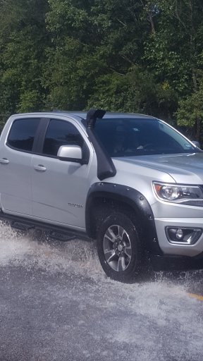

Ive seen ones like the one on my colorado on suburbans and silverados so id reckon it would work for you, mine is made for a isuzu d max 3.0 diesel
I was looking at one similar to yours, but the end is a little more rounded and the inlet rests over the windshield just unsure if it will reach that high when i line it up on the fender where i can have the access hole.
where did you pick yours up at ?

Is it the dog leg 1 piece type that runs along the fender, or 2 piece like mine where the dog leg is inside the fender? Reason i ask is the one piece ones you have to be sure it fits ,with 2 piece you can mount the outer body and connect to airbox with flexpipe if needed
