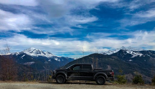

Just picked up my new toy and will be slowly modding it so that it is more capable while exploring. This truck is replacing my Toyota FJ which was very capable off road. However, it was not very comfortable to drive to and from work and as my kids have grown there just wasn't much room for us all. This thing has tons of room for everybody inside and the bed is a nice feature when it comes to needing to haul things. So I suppose this is kinda a multi purpose vehicle.
Gen 2 Ford Raptor 802a (bone stock)(removed the running boards)
