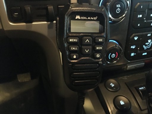

I did a Scosche mount on my truck for my MXT275. I removed the round clip off the mic and did 3M heavy duty double sided tape to mount the metal plate as the adhesive for the plate mount was not strong enough. I mounted the magnet part to the dash. I get to redo it because the adhesive is not strong enough in the heat for it either. Otherwise it appears it will work okay. I was going to do the Nite Ize, but didn't want to wait for shipping. I got the Scosche at target.
