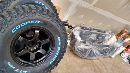

As the mods start to flow, I choose a new path for wheels and tires. Dustin over at FN wheels due to my persistence created a new version of the Six Shooter Wheels. 17x9 with a -12 off set. This is perfect aggressive Toyota fitment for any tire larger than 285. I also coupled this with some Cooper St Pro Mt Tires in 315-70-17 with the white letters out! 22.jpg

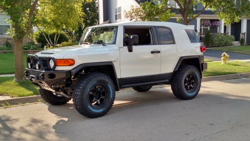

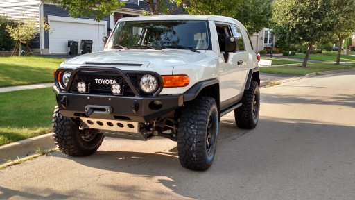

Bumpers, bumpers are the base for so many thing. They protect your truck, offer a winch mounting solution, give locations for auxiliary lighting and enhance the look of the truck! I chose shrock works bumpers out of Texas. I will tell you that I ordered this bumper before I even found my FJ! call me nuts, but I knew I was getting another one, just a matter of time. Having installed, Demell, Metaltech, ARB, All Pro, Warrior, and several others. This bumper just fits the bill. This bumper sits nice and tight against the front of the truck. It also sits high and affords an awesome approach angle. The fit and finish is excellent and second to none. Its also no very heavy around 85 lbs. The top bars protect the head lights and grill and don't protrude any further than they need to for their job. I rounded this install off with a warn M8000 winch. I had previously had a warn winch that I had purchased in 2008 and kept it on several trucks through 2013 and never had a problem with it. So I got another one. Synthetic line for weight and safety. I also added a remote control unit so I did not have to futz with plugging anything in during a recovery. I also have a hard wire line run to the cab to operate the winch from the dash. 21.jpg23.jpg 24.jpgIMG_20160726_175115433_HDR.jpg IMG_20160726_175123307_HDR.jpg IMG_20160726_175128692_HDR.jpg

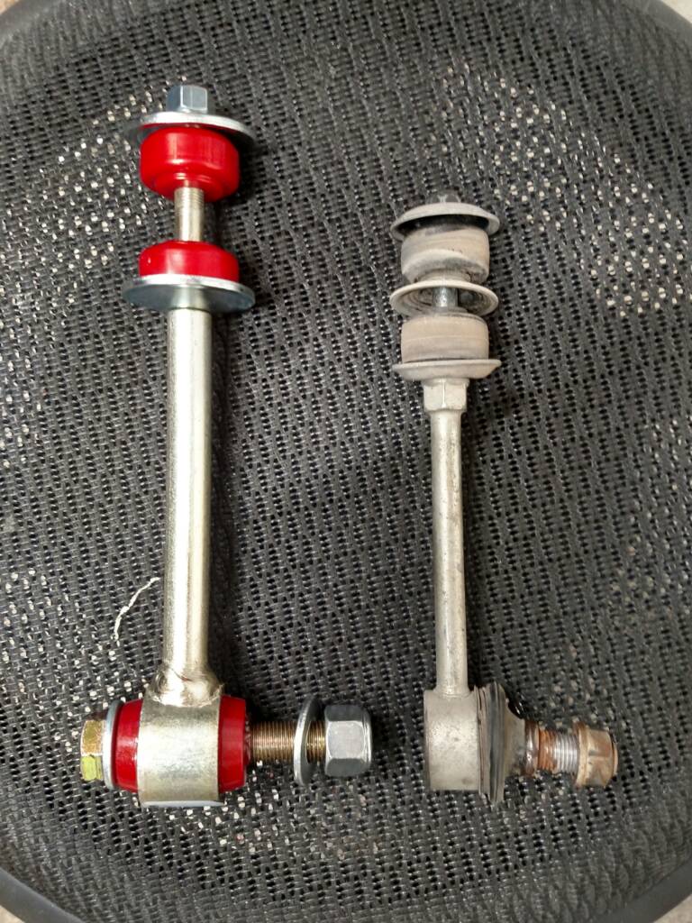

I'm playing around with some rear suspension components. Since I'm lifted 2" I got some extended rear sway bar mounts for the rear from super lift. They are also quite a bit stronger, not that I have ever had a set fail. The extra length allows the fj full use of its articulation with sway bars attached.

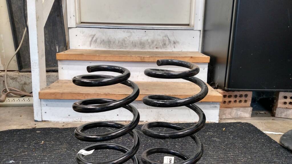

Also, decided to swap out rear springs and loose some of the rear height. Went with the ome "e" mediums. These springs are identical in stiffness, but one gives 2.25" of lift, the other 1.5". Now I can lower my front a hair and have a more controlled down stroke and retain a closer to stock geometry. No reason for this rig to sit higher than it needs to.

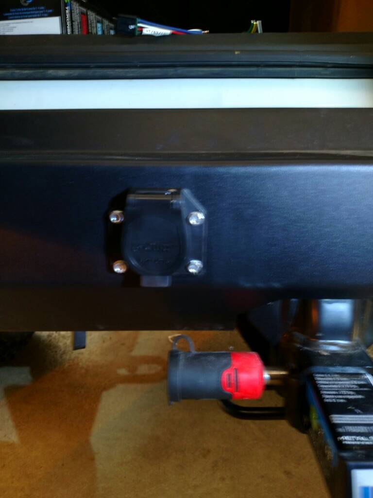

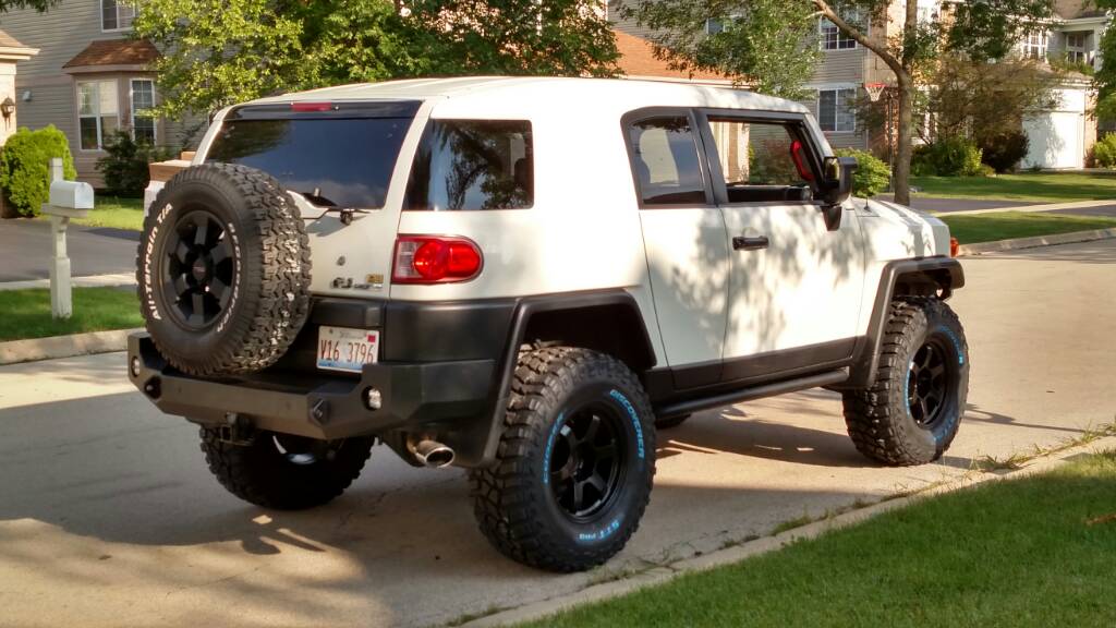

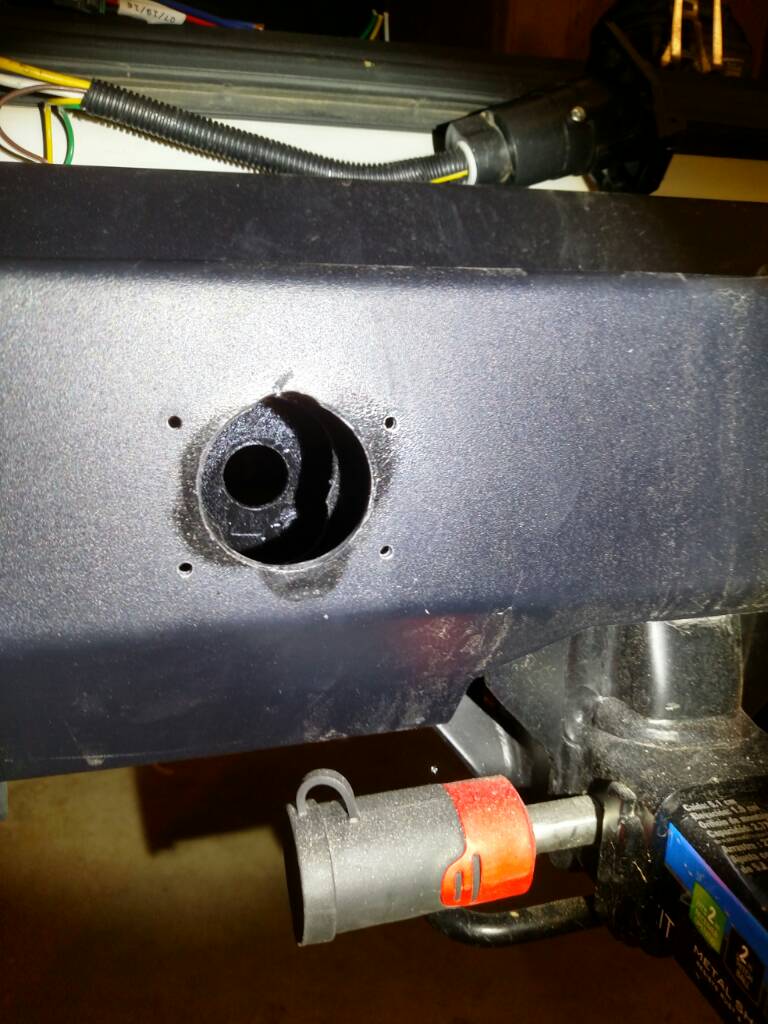

During the rear bumper install, I went with expedition one. I liked that it followed the stock lines, offered great protection, extraction points that are easy to get to and a great step platform on the corners of the truck. There is a natural hole in the oem rear bumper that allowed mounting of a 7 pin harness in the bumper instead of letting it hang down unprotected. I still need to wire up the rear back up lights and the trailer brake set up. The back up lights are a perfect fit from baja designs squadron round.
