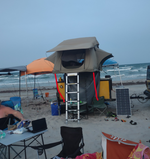

Sometimes the ground is not exactly level when opening up the roof top tent. This causes my ladder to either be to straight up or angled to much. When angled back more, I don't feel like the end of the tent is supported as much. I know others that have told me the same about theirs. I am considering on making two support rods that go from each end corner to frame of trailer.
My question(s) is:
What have others done to resolve the issue?
Has anyone made supports?

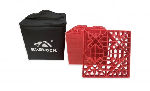

I always keep some leveling block to put under the ladder when the rig is to high, and I have drilled some hole to help me adjust the ladder shorter if needed. Keep in mind that the ladder bar will not be align when shorten.
Would you post a picture of the leveling block? I am curious on that.

I use them to level the ring also. There is a groove in the center, the ladder fit perfectly on it. You can found the equivalent on Amazon under 40$

Here is what I have now. I was in the sand and able to got deeper with ladder. The red lines are an idea I have. They would be 1x1 tubing pinned in to corners of rtt flooring to frame of trailer and pinned.

When I had my RTT on my trailer, I considered the same thing. Even though I had no issues, I didn't like the ladder holding the platform. If I still had it, I would have added in a couple of support poles.
Because my ladder would move on me once in a while, I would tie and stake it to the ground.
I have had big wind gust try to fold me up in the tent. It was actually pretty dang funny afterwards. This got the ladder all out of whack at the moment and I climbed out the window of the tent and down the trailer.
Also, I am 250 and I sit on the edge to put shoes on. When ladder is not angled right, that is a lot of weight to hang off the hinges.
