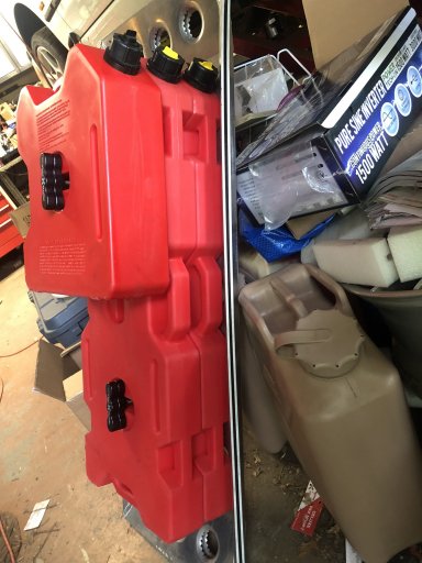

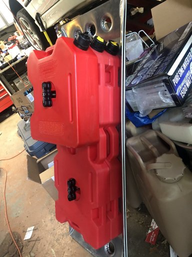

Only about 7 months ago, I purchased two 2-gallon Rotopax fuel canisters. I mounted them on the back of my Jeep JK with the Rotopax Deluxe mount that they offer, stacking them flush against each other. There has always been a little bit of a challenge getting the mounting handle on, since there aren't many additional threads to guide into the hole- maybe 3/16".
The fuel canisters were pretty good for the first 5 months or so, as I would mount and dismount them occasionally, while leaving them off in general for my daily commuting. This past winter here in California, the snow levels have been absolutely tremendous, so I took a few trips to Tahoe with the Jeep, Rotopax canisters mounted full with fuel. They pretty much just stayed there for a good 2 months or so.
The other day, I was low on gas. It was late and I was about to make my way home from work. Rather than hunt down a gas station, I elected to empty the Rotopax containers feeling like they could use a refill of some fresh gasoline. (BTW, the spouts they provide are pure shit. I would advise buying replacements- the locking mechanisms will just break on you anyway.) After putting the gas in my vehicle, I tried to mount the empty containers back onto the mount, but there was NO WAY IN HELL they were going to mount up again! Both containers had warped and were now swollen to a point that there was more than 1/2" of space between the end of the mount bolt thread and the hole it needed to thread into. Those canisters are very stiff and it takes a lot of effort to get them to budge even just a little. I threw the empty vessels in the back of the Jeep and drove home.
Rotopax containers come with a 10-year warranty. I emailed the company to explain what my situation is and if they could provide me with a fix. I fully don't expect them to provide me with new containers (nor would I want that, considering that in 7 months, I would be faced with the same problems), but maybe a mount with a longer bolt? I suppose I could try and unthread it myself and see if I can't find a longer stud at my local hardware store, but I really shouldn't have to do that. It's been two days now and Rotopax has been unresponsive.
So just a word to the wise- if you're planning on stacking more than one Rotopax container, you many encounter non-fit issues after some time. I am waiting on bated breath to see if Rotopax will actually stand behind their product. To see if they're going to acknowledge me at all.

A quick follow up already. I just received an email from Rotopax. She was kind enough to point out to me that there is a reminder in the product description that says that the container should be vented "if the elevation or temperature changes significantly". I did burp the containers while in the Sierras, but I guess it must've been necessary to vent them even at sea level since the recent temperatures have been varying largely, hence the deformity of the products. Nonetheless, she is going to send me out the next largest extension to remedy my problem. Lesson learned. And I'm satisfied with the Rotopax response after all :)
